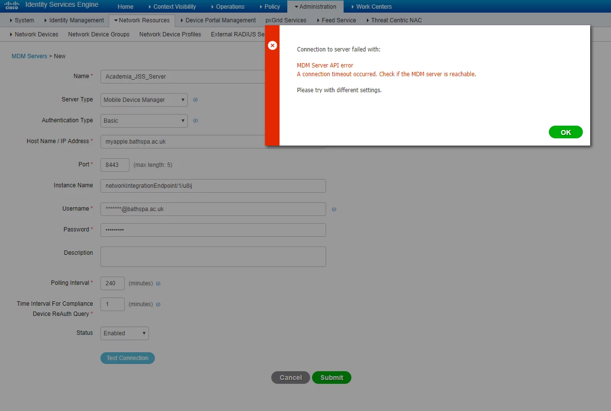

Has anyone come across this?
I am trying to add our JSS MDM server to our Cisco ISE but keep getting a connection failed MDM server API error.
3 replies
  • Employee
  • February 27, 2019
Can you try port 443 instead of 8443?
Forum|alt.badge.img+19
  • February 27, 2019
Your username should be exactly what you login to the Jamf Pro Server with, can you remove the @bathspa... portion and try again?
  • February 28, 2019
Thanks, it was port 443. Although I am now getting an error with the certificate trust store because we are using a self signed cert on our ISE so need to update that.
