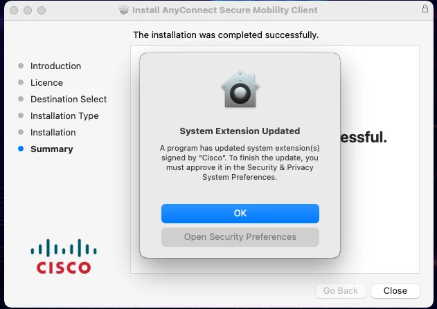

Hello There,
I am wondering if there is anyone using Cisco VPN Any-connect 4.9 in macOS Big sur Beta? I installed it but it is giving me error right from start and I can't even launch it. Please see the attached screenshot for the error.
Any help appreciated. Thanks.

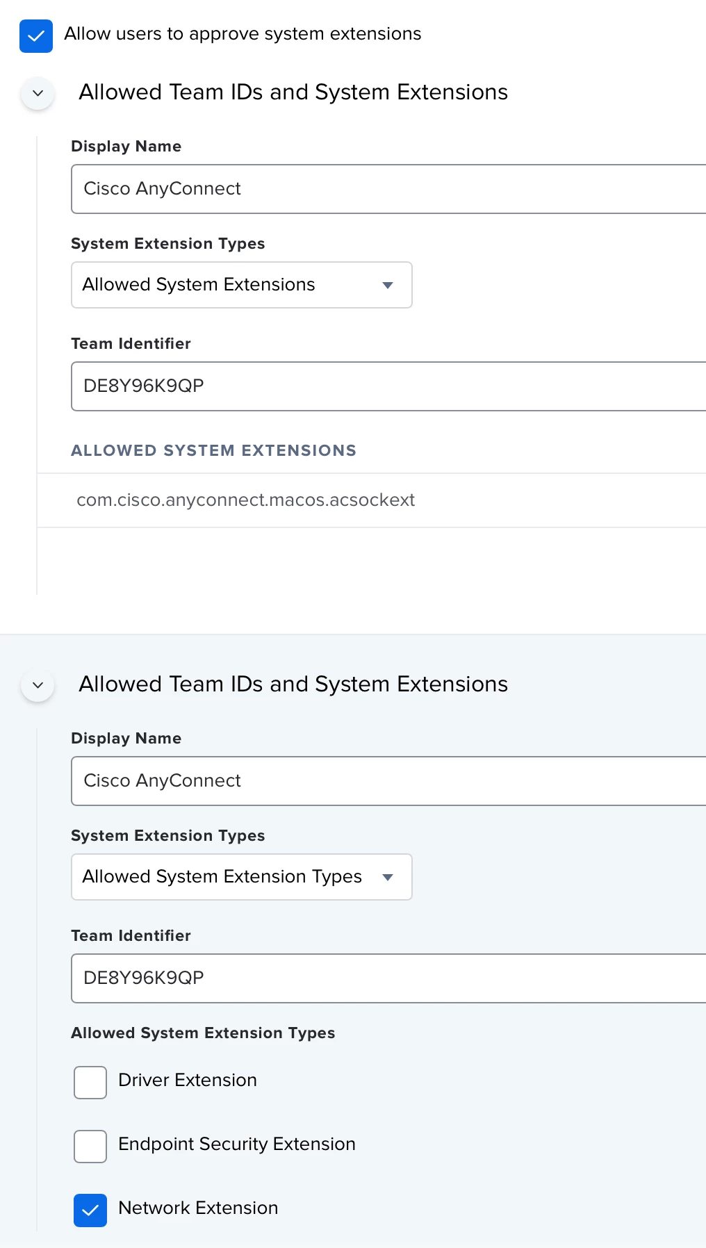

Has anyone whitelisted the Cisco AnyConnonect 4.9.02028 System Extension (com.cisco.anyconnect.macos.acsockext) from JAMF Pro Configuration Profile successfully?
We attempted to whitelist the Team ID 'DE8Y96K9QP' but the following System Extension warning message is still prompted on macOS 11 Big Sur beta 6.

@takayuki Thanks. it worked perfectly fine. I created system extension with the values you suggested and deployed it to my test computer and it is working fine.

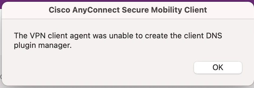

@raghdasi @takayuki I see this was "Solved" but I don't actually see any solution here and the post that was marked solved is just a question if anyone was able to get it to work.
We currently have 4.9.01095 deployed and I have run into the same issue as the OP when testing on BS. As suggested, this version may not be fully supported but it does work on systems where AnyConnect was installed prior to updating to BS. New installs, however, are coming up with the error about being unable to create the DNS plugin.
To add to this, we had an instance of someone who was running on 10.15.5 run into the same problem. If anyone has managed to fix this, I would really love some insight into how you got around this.

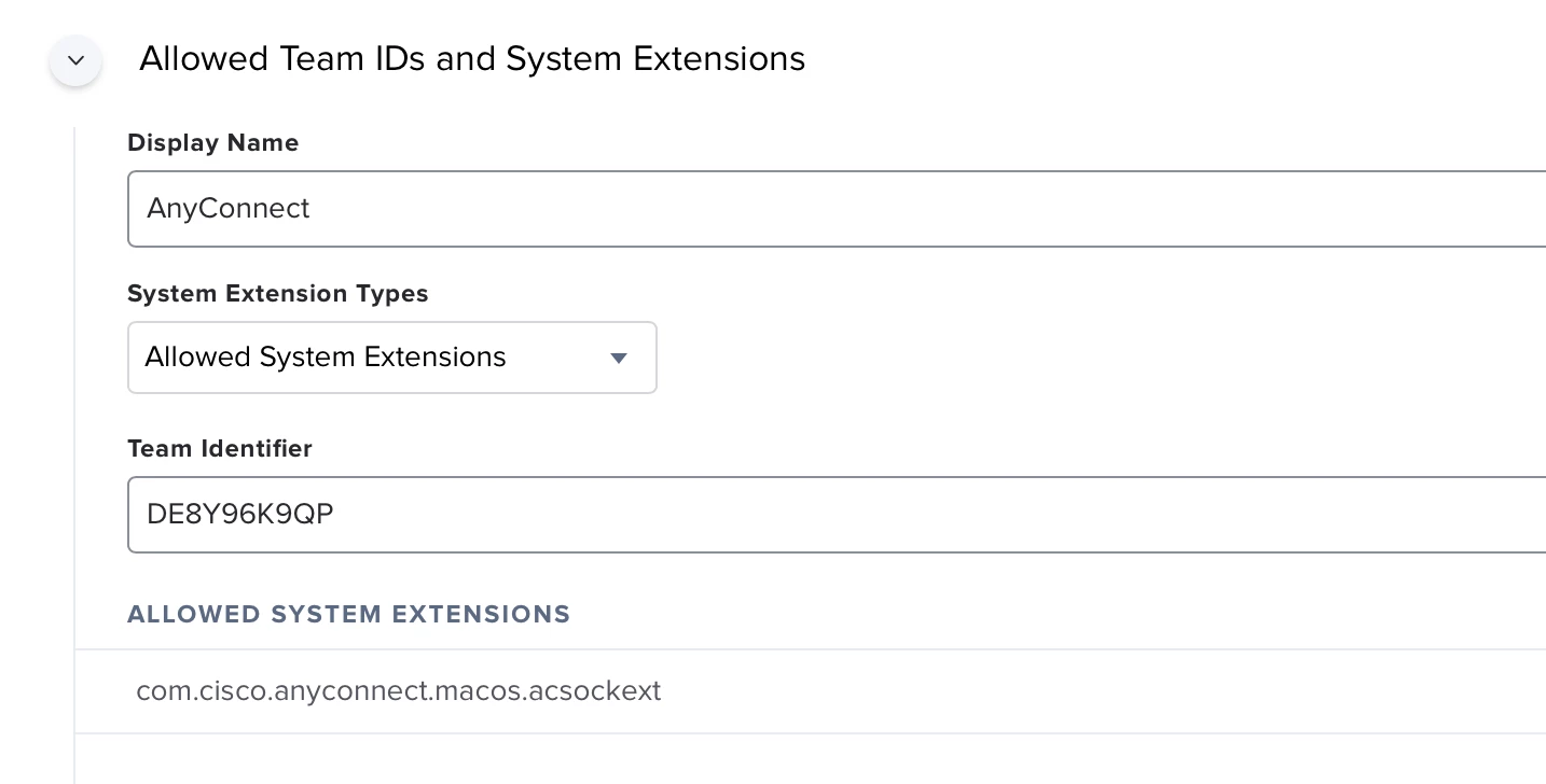

I haven't tried the sample profile but got the system extension approved using the following profile:

At first I had an additional entry which only allowed the team identifier but read somewhere that it may not be necessary so now I only have the one entry to allow the "com.cisco.anyconnect.macos.acsockext" extension which seems to work as I'm no longer prompted to allow the extension and 'systemextensionsctl list' shows the extension as enabled and active:
enabled active teamID bundleID (version) name [state]
DE8Y96K9QP com.cisco.anyconnect.macos.acsockext (4.9.03047/4.9.03047) Cisco AnyConnect Socket Filter Extension [activated enabled]
