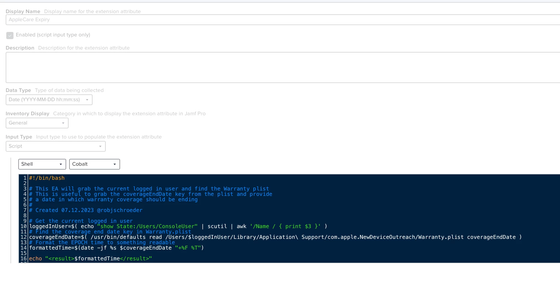

Appears to be working in my environment,
what I did wrong at first is put it under description, instead of as a script in the extension attribute query
see how I have it setup in the images below within extension attribute (shame we can't do the same for iPad)
