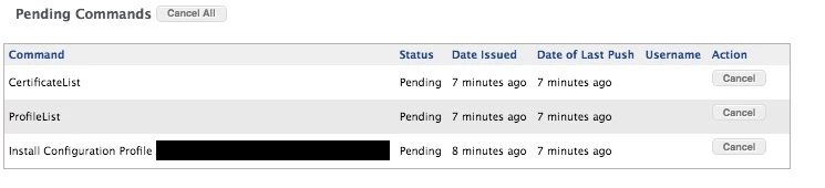

So far as i'm able to determine, there's still no way to trigger a 'blank push' progmatically, but that's what works most of the time. I've tried pulling the mdmprofile, which pulls all profiles. Then I follow up with a jamf mdm, or jamf manage which enforces about %70 of the time. When stuck pending the profiles can just sit there for days.
Unfortunately, this is a proxy configuration and needs to be in place within seconds. The scope is limited by network segment, which can be fun trying to update while the proxy is enforced and your off-net.
I'm starting to really hate profiles. They are not reliable in the slightest.
@NightFlight – I've had pending profiles stuck in place for months. It's really annoying since I'm trying to push out a new config profile for wifi since my company is moving to new offices with new SSID information, and nearly 60% of my managed macs aren't pulling the profile. It's been pending for 24 hours now on all those machines, but I see some of those machines have profile pushes going back to January and December. :-(
@michael-brodt – Thank you for that little script. I tested it and one of my machines that was still waiting on profiles now finally has those config profiles installed.
