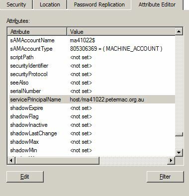

I'm assuming that you're bound to AD as well?
We use this setup, and I had to make sure that the "servicePrincipalName" attribute for the Computer Object in AD was set correctly for each device. This should be in the format of "host/[FQDN of device]".
I also had to set up a script to run on the Mac itself for a kerberos service, otherwise it clears out this attribute everytime it authenticates:
dscl . -create Computers/localhost kerberosServices host

@Aaron Interesting...perhaps that would explain why I cannot get the correct information in the certificate. Something I will definitely try when I am back in the office next week. How did you implement that script, and how often are you running it?

@sdiver I normally only have to run it once, so I have it as part of my initial setup script. There are some random moments where something will get changed on the client, and it will update the AD record, and then the Mac can't connect anymore, so there's not much point in having it as a policy (unless you have a BYOD section to your network which can access your JSS). When that happens, I just run the command manually - I'm yet to determine what causes it, but it doesn't happen terribly often, so it's not a big priority for me.
When I was doing this, I found that everything worked better if I handrolled and manually signed the config profile before uploading it to the JSS, as there were bugs which were mangling the profile. Can't say if that's been fixed in recent versions.
