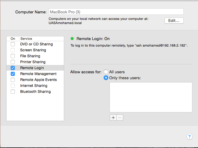

@stevewood but after enrolling the computer i could not change the computer name anymore. its grayed out. is there any command i could force the computer name on the jss going to the computer?
  • August 11, 2016
@easyedc i'm not naming them as same. what i'm doing i reimage all our harddrive from a fresh yosemite os then we are changing the computer name as per user name. then after the enrollment it will change again to the default computer name.

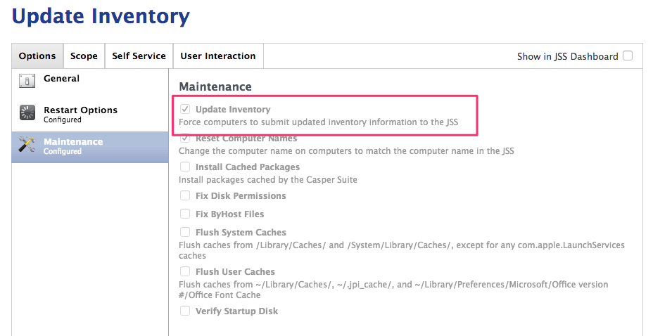

To answer your last question to me, whether you can force the name change from the JSS, the answer is yes. If you set the name in the JSS, you can update your inventory update policy (mine is "Update Inventory") or create a new policy to update inventory, and on the Maintenance tab choose "Update Inventory" and "Reset Computer Names". You can see that I have both of those checked in my Update Inventory policy that I posted above.

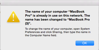

This is the error message that we are getting if the computer will change automatically.
that will just pop out the computer name will just change
