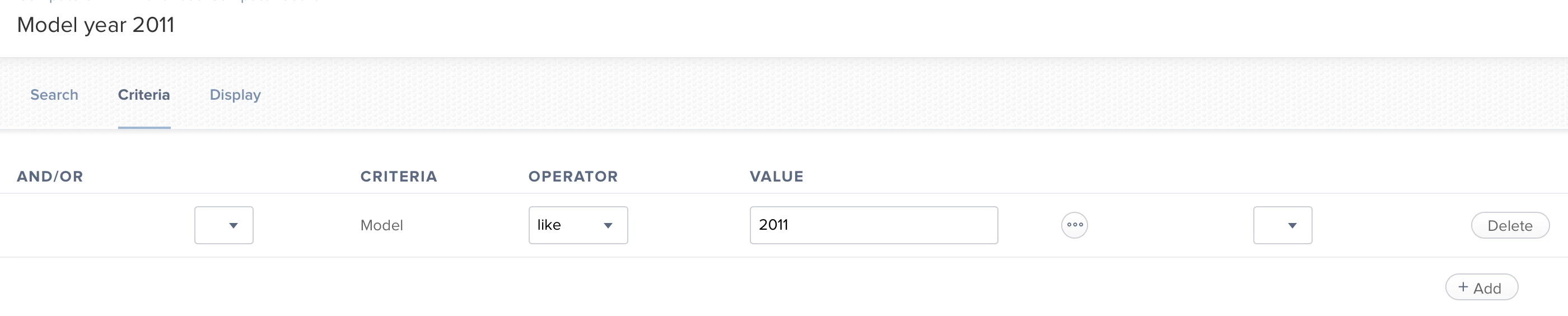

The quickest way to do it a search would just be a model year search, but that doesn't quite match the "over X years old" question.
Now granted, given that years don't change that often, you could probably just build a broad search (ie Model year like 2011 OR year like 2012, etc) and take care of most of your needs with minimal adjustment every year.

Then I have a smart group that will report if it is over 1465 days ago as we refresh every 4 years now.
i would recommend using the models for criteria, as was mentioned above
