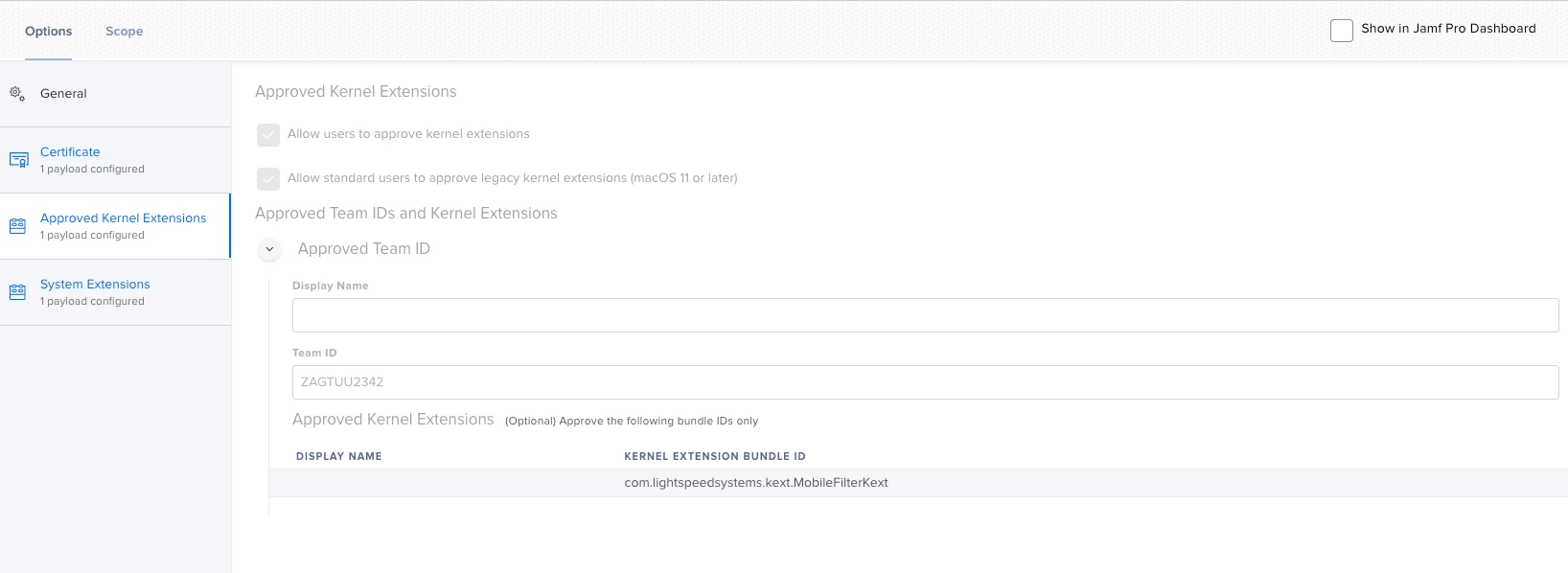

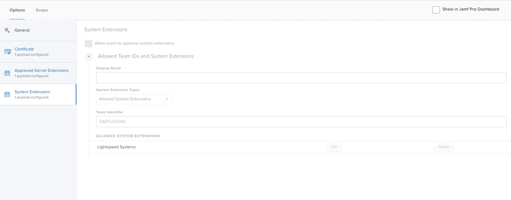

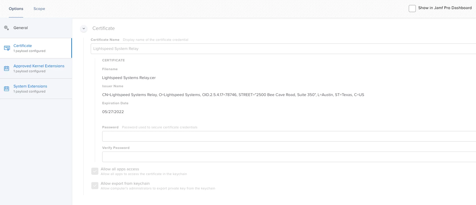

I have been working on setting up our Lightspeed smart agent to push out using JAMF over the last couple of weeks and keep running into problems. My current dilemma is with Lightspeed Relay Agent 1.6 and the system extension. I have a configuration policy setup to allow both the KEXT and the system extension (KEXT was for Relay agent 1.5.2) and the Lightspeed Relay cert. When I grab a computer fresh out of the box and set it up, the agent installs but the system extension still asks for user authentication to approve it. I have played around with the setting, such as allowing user auth or no user auth, using the various system extension types drop down and adding Lightspeed Systems to the Allowed system extensions. The weird part to all of this is if I redistribute the configuration profile to the test computer while it is asking for the system extension to be allowed, it will authorize it no problem, however, if I do not do the redistribution, a user has to manually click on allow and enter their password. I am wanting to make it so that the system extension does not need user approval and will just automatically authorize without user intervention like when I redistribute the configuration profile. Anyone have any ideas that could help achieve this?

Sorry to update this over a month later.  I worked with someone from JAMF and the solution to the problem I was having was to separate the KEXT and System Extension profiles and deliver each to the appropriate computer.  So the System extension profile goes to 10.15+ computers and the KEXT goes to everything below 10.14.  This seems to have taken care of most of the issue we were having as far as deployment.  Problems with Lightspeed are a whole other matter and we could start a whole other thread or 2 on that topic.  I did find issue even after separating the profiles, it a computer somehow ended up in groups that set it to have both profiles.  To fix those problems, I have to work through making sure groups did not overlap and once the computer had the appropriate profile it usually worked.

How did you end up deploying the cert that ends up in the user's keychain to be automatically trusted? I am trying to deploy this to standard user laptops (students). Since they aren't admins, they cannot mark certs to be always trusted.

We ended up not being able to push the cert.  Instead we have to use a configuration policy that allows either a system extension or a KEXT (based on operating system) to allow everything to be installed properly.  We also had to use 1.5.2 and 1.7 for the version of the smart agent as 1.6 was pulled for causing more issues than it fixed...  1.5.2 is only used on 10.14 and below with the KEXT configuration policy and 1.7 is used for all devices 10.15+ with the system extension configuration policy.  Do not add both payloads to the same configuration policy or you will have a headache trying to figure out why the installs are not working properly.

1) Create a New Config Profile in Jamf Pro
2)Select Certificate Payload on the left, Make the Certificate Name is spelled exactly "Lightspeed Filter Agent" , upload the ca.cer certificate file you extracted
That should do the trick
  • September 14, 2021
Thanks for the hint, do you deploy as computer or user level? It still keeps the cert as untrusted, so it is still asking me for admin credentials.
We found when we pushed the cert that the smart agent would not recognize it and re-install the cert with the untrusted settings, which is why we ended up ditching that idea.  I failed to mention we also created a setting that force restarts the computer after the smart agent is installed.  We found the best outcomes for installing the smart agent is to use the script provided by Lightspeed for MDM deployment, where it curls the .dmg from the Lightspeed AWS portal and then opens the package, installs it, and deletes the .dmg.  You have to push the configuration policy with the KEXT or system extension before running the deployment policy with the script.  From there we give a 5 minute timer and the computer force restarts.  The cert does not seem to be an issue once we started doing it this way.  A big part of it was using the script and using the appropriate KEXT or system extension configuration policy based on the OS needs.
