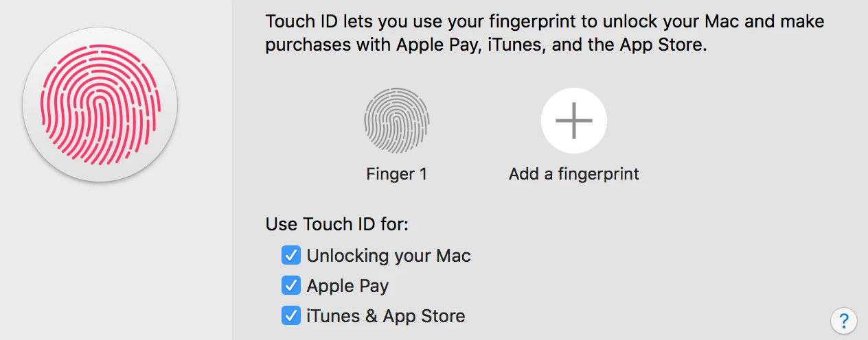

Hi !
We are going to pilot TouchID in our environment icm with Managed Mobile Accounts, so currently all our macOS devices have an configuration profile where TouchID pane is disabled and also the features to unlock the mac.
On my own machine i have removed that profile, and allowed TouchID.
What happens is, the syspref pane got accessible again and all checkboxes also.

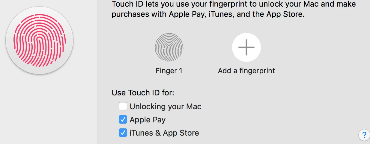

When i configure a vingerprint and check the box and i am leaving the syspref pane and went back to TouchID the "Unlocking your mac" got unchecked again.
Already done all basics like;
- rebooting
- re-enrolling into JSS
- Verified the correct configuration profiles are deployed and no other one is also disallowing.
Configured TouchID
Went back to TouchID Syspref pane, and box unchecked
Anyone ran into the same issue?

Well, we made the Touch ID work again by deleting the Keychains.
Afterwards, it was necessary to repeat the fingerprinting process (and of course start capturing back all the passwords) but now the machine can be unlocked with Touch ID.
sudo bioutil -w -s -u 1
  • Sep 5, 2018 1:26 AM UTC
Perfect - that worked ! thanks @Rememberfarley
Even though a config profile was deployed with a Restrictions payload which enabled use of touch id to Unlock your Mac, the below error was displayed when attempting to run the above bioutil command.
"Unlock with Touch ID is managed via a config profile. You have to uninstall the config profile first.".
So you need to de-scope the config profile to exclude any effected devices, then run the sudo bioutil -w -s -u 1 to enable, then if required re-scope the config profile with the setting enabled - to the required device(s). Potentially could run the command fleet-wide via policy first, then deploy config profile. Additionally you could also use an EA to determine devices that are encountering this issue using bioutil -r to read in the ""Effective Touch ID for unlock value" which shows as 0 for devices you would want to change. We are fortunate that we are only just introducing macs with touch-bars, so no remediation required :)
Tangentism
  • Sep 5, 2018 10:01 AM UTC
Had this issue with machines on my estate as when they were enrolled, the JSS was on v9.x. When I upgraded it to 10.4.1, the users could not unlock the machine using Touch ID and it kept resetting if it was enabled but they could use TouchID with Apple pay, etc.
After a bit of poking around, I found that I had to:
  1. Exclude their machine from the MDM profile
  2. Run the bioutil commands [see below]
  3. Re-apply the MDM
  4. Re-add their fingerprints.
