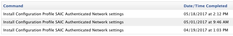

Is anyone else seeing an issue where Configuration Profiles are being removed and reinstalled randomly? Usually not an issue until we started deploying AD Certificates via Configuration Profile. If the machine is not on the Corporate network then the reinstall fails and when the user comes back into the corporate network they cannot connect because they don't have the Certificate.
To be clear... The JSS is not issuing a remove profile command, the profiles just disappear and the JSS attempts to reinstall them.

We have over 800 Macs enrolled in the JSS and every single machine loses config profiles for our cert-based wifi and VPN weekly. Based on the consensus in this thread, it may be worth it for my team to look into creating a script instead of relying on the APNs if this is a bug that jamf can't shed any light on.

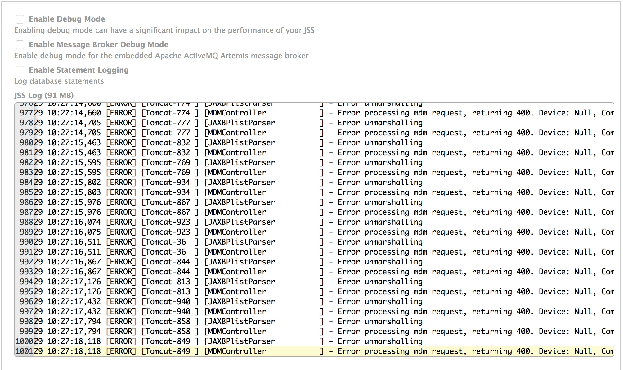

I'm curious if the fact that our logging is getting spammed to hell with entries like the following (see below) is indicative of the issues posted here. I'm also curious to see if other folks are getting similar errors in their server logs.
2017-12-29 10:41:00,740 [ERROR] [Tomcat-897 ] [MDMController            ] - Error processing mdm request, returning 400. Device: Null, CommandUUID: mraNull
2017-12-29 10:41:00,740 [ERROR] [Tomcat-884 ] [MDMController            ] - Error processing mdm request, returning 400. Device: Null, CommandUUID: mraNull
2017-12-29 10:41:00,756 [ERROR] [Tomcat-207 ] [JAXBPlistParser          ] - Error unmarshalling
2017-12-29 10:41:00,756 [ERROR] [Tomcat-207 ] [MDMController            ] - Error processing mdm request, returning 400. Device: Null, CommandUUID: mraNull
  • December 29, 2017
@emily that's the exact same error message I'm seeing in our logs. baffles the mind. i commented on it over on this discussion. i don't know if i ever included an update to it - jamf basically says that this is due to an issue with our wireless network which is causing timeouts.
