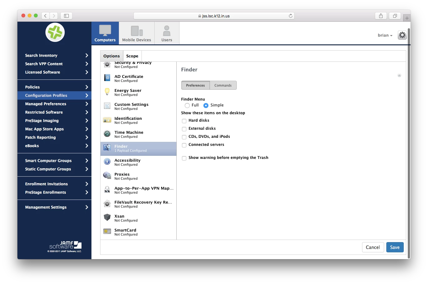

I'm trying to set the Finder to simple. That works. But I also have (under the commands tab) show shutdown and restart. That doesn't work. Is this a bug or is this mutually exclusive (simple finder = no shutdown or restart in the apple icon)?
I was about to write up a whole "set your Finder settings on a test machine and convert your plist keys to a profile using a custom payload..." when low and behold... in 9.98 (and possibly earlier...someone would have to confirm when) there is a Finder payload you can set for Simple Finder:
Yes but if you set finder to simple, it renders the commands tab unusable. So if you want a simple finder but also want to expose the shutdown and restart, you can't.
I think you'll find that Simple Finder was intended to be a Kiosk Mode, explaining why Shutdown and Restart are made unavailable.
