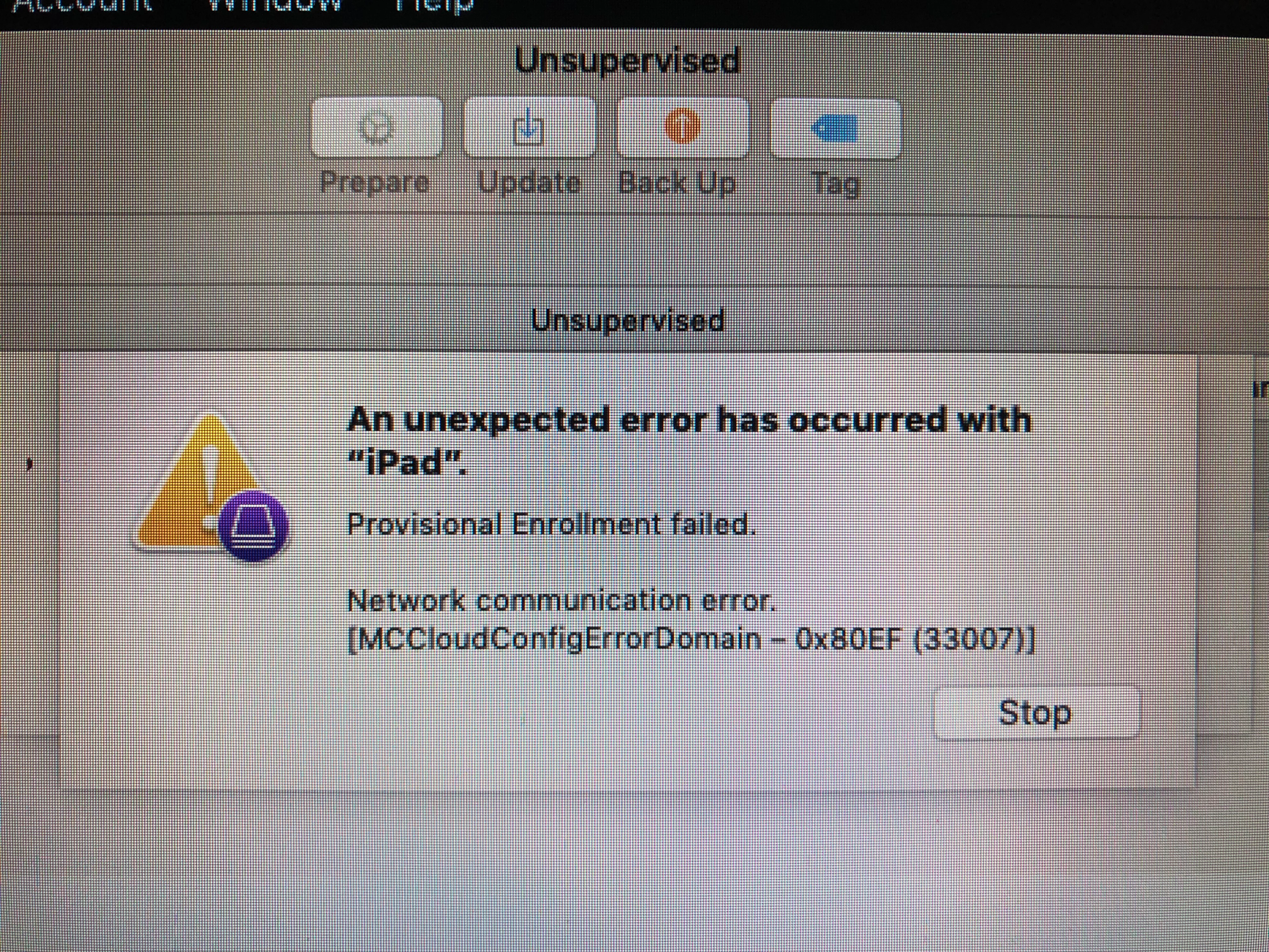

Anyone know if you can add a device again after a person clicks the leave remote management button at the setup assistant on a provional DEP enrollment?
We have this working fine but one of our techs clicked that button on one of the devices we were using to test by mistake and it dropped out of DEP as expected but now we can’t add it back. Curious if it’s the same as when it’s a vendor/regular DEP device and you drop it from DEP and it’s gone forever or if there is a “cool down” period before you can provionally add it in to DEP again through Configurator.
  • October 4, 2017
Thanks for the suggestion @jared_f .
With further testing, we found the issue was fixed when we included a Wi-Fi configuration profile to our network. Thanks to those above for the suggestions to do this.
For anyone out there with similar problems, note that it is essential for the devices themselves to connect to the network to complete the enrolment. They don't do this via the USB, they need an independent conneciton. So unless you have a cellular-based iPad with SIM and connection to the Internet, you must add a configuration profile in the step where it asks you to.
This resolved the
MCCloudConfigErrorDomain – 0x80EF (33007)
error for us. As such, this error may not pertain to whether the device is already enrolled - unless it means both. We tried to unenroll the device with the error returning that it was "NOT_ACCESSIBLE", i.e. it could have been enrolled in another DEP account, but this was not so as the issue was fixed by the above.

We were getting the same "Provisional Enrollment Failed" error, but only with AppleTV (4th Gen). iPads work fine. It's the craziest thing.

Managed to get past MCCloudConfigErrorDomain – 0x80EF (33007) the ipad we were using, although new, had already been DEP enrolled by another onsite tech. Still working my head around how to use a wifi profile for the enrolment and then have the MDM remove the wifi profile later on. Also last attempt, while using user credentials, didnt assign the user to the device, is this a bug?

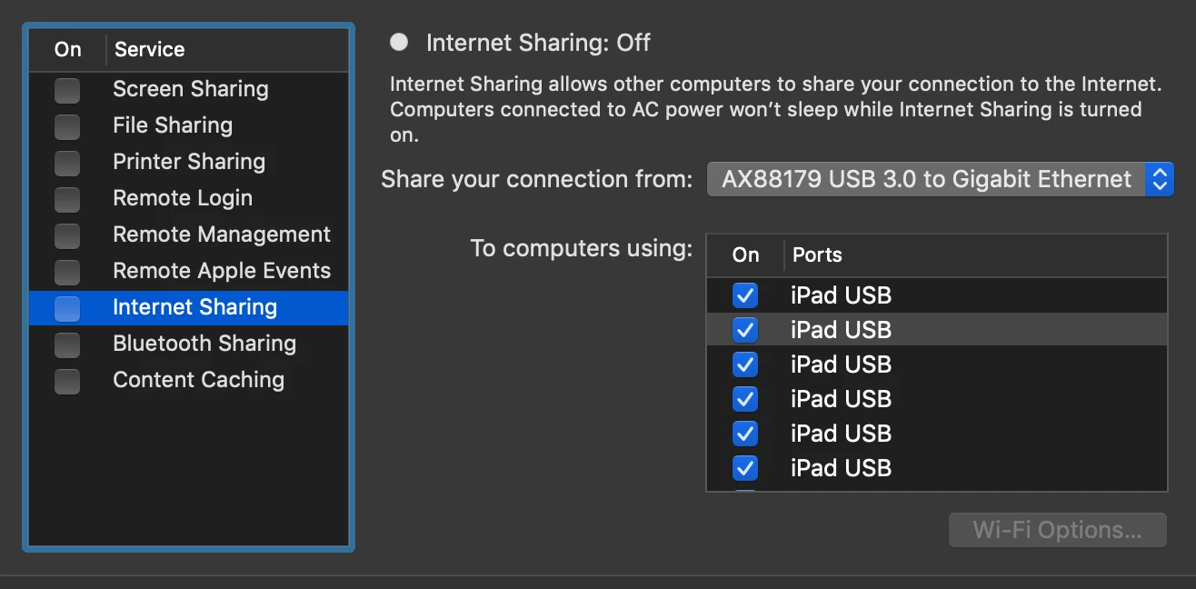

As we are using wpa2enterprise we cant wifi share our macOS connection via lightning bolt and pass the requirement for the internet access, which has been a bypass for some.

I am also looking at sharing the internet access option, with a wired desktop over my laptop.

We had one iPad with the MCCloudConfigErrorDomain – 0x80EF (33007) error. The iPad that was accidentally disowned that was in our DEP previously. If it has ever been in anyones DEP previously the Configurator 2.5/iOS 11 method to get it back into a DEP/ASM will not work according to AppleCare. So in theory if you had some iPads/iPods donated from another school system or business that had them in DEP even though they disown them it will not allow them back into DEP at this time (10/31/2017). However they did take the serial # and I took a picture of the back of the iPad and uploaded to the Applecare ticket but he didn't hold out much hope it could be added back into any DEP account.

Provisional Enrollment failed error Network communication error. [MCCloudConfigErrorDomain – 0x80EF (33007)]
I recently ran into this issue with Apple Configurator and iOS 11 and 12 devices when I adding devices to DEP.
I went through the trouble of configuring a wireless profile but it wouldn't seem to hold.. Eventually I found out that if I just go through the first prompt and sign in to wireless on the device and then run the DEP setup on Apple Configurator with a fake MDM server, the device would get added to DEP and I could then assign it to our MDM.
After DEP is completed, you could then go through the DEP enrollment and the device would connect to our MDM.
stephaniemm77
Hello We are still getting this error as well with iOS 12.4 Anyone have a fix?
When we got that error message, the device was available in DEP and we moved it into Jamf. After that we just wiped through Apple Configurator and went through the Setup Assistant to make sure it was picking up the MDM and installing the applications.

I'm getting this same error and the device is not in ABM (DEP)

We come across this problem when our wireless profile cannot contact the network. In order for the iOS devices to reach the enrollment page with Apple, they need to have a network connection. To do this over the lightning cable, open System Preferences > Sharing from the macOS device running Apple Configurator. Check the box for each "iPad USB" in the "To Computers Using" section before enabling Internet Sharing (There will be one box for every iPad plugged in, so if you have more than one, check each box).
  • January 14, 2020
I had the same issue and it was as simple as my wifi not responding quickly or consistently enough. I created a separate AP that sits right near my sync station and is only used for AP2 initial DEP enrollment. Works a treat!
