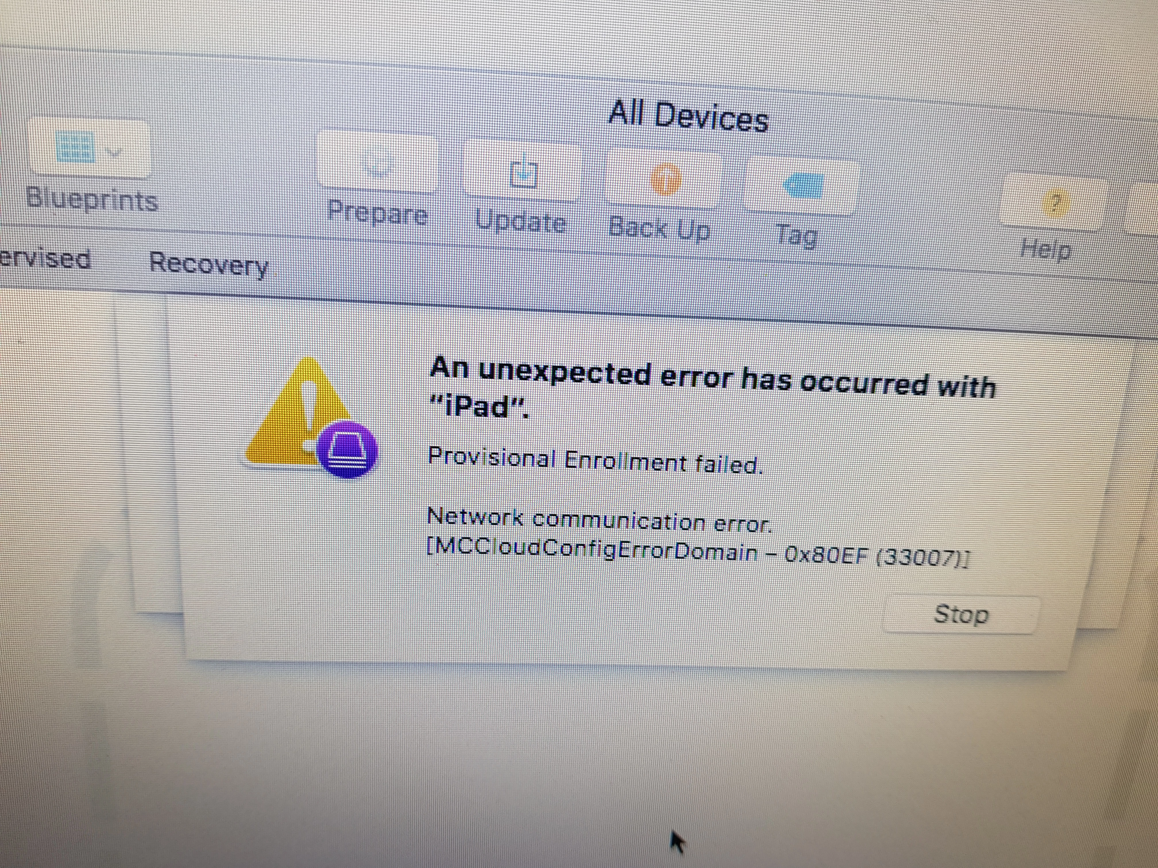

This unfortunately doesn't help the issue I'm having. When trying to add a device to DEP I get the error:
Provisional Enrollment failed error Network communication error. [MCCloudConfigErrorDomain – 0x80EF (33007)]

Good Afternoon All
I hope someone can help me as I am struggling abit with apple configurator 2.5 after I prepare the Device it gives and error after it trys to activate the IOS on the Ipad. please see picture below.
Much appreciated
Our web filter was the culprit in our setting when enrolling/preparing devices. When they rolled out iOS 11, they must have changed the site that devices use and it isn't open for us. Waiting on my network admin to find out which sites need to be opened in order to get it to work properly. Using an iphone and cell network as a work around right now to get my devices enrolled.
We found we had to open ocsp-ds.ws.symantec.com.edgekey.net and exclude it from any https inspection. iOS10 worked fine without it open but iOS11 didn't.

Thanks for all the help in this thread. Unfortunately we're still getting the
error. Our network is not blocking any of the ports, and we can't enrol or disown the device from the DEP portal. My only thought is that the device is enrolled in some other DEP account, not ours.
Is anyone able to provide further assistance? Thank you @maurits for the guide, unfortunately we still can't add the device.
Thank you!
@lachlanharris Try deleting Configurator and re-installing it. Make sure you add back any organizations, servers, and supervision identities when setting up your new configurator instance.
