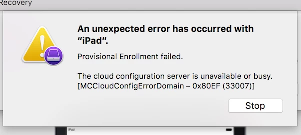

Hello,
In using Configurator 2.5 to enroll devices in our DEP I encountered the below error on some of our iPads:
An unexpected error has occurred with “iPad”.
Provisional Enrollment failed.
The cloud configuration server is unavailable or busy. [MCCloudConfigErrorDomain – 0x80EF (33007)]
I called AppleCare Enterprise. They checked the devices that I was trying to add and indicated they are or were enrolled in our Parent School District DEP. This prevented the iPads from being added to any other DEP. Even if the devices were removed from their DEP they cannot be added to a new DEP. Sharing in case anyone else receives this error.
CORRECTION - The person I initially spoke to at Apple Care Enter price was wrong.I was able to have our parent district go into Apple School Manager, input the serial number and choose "Release Devices." I am now able to add this to our DEP!
It basically translates as : "This device is not eligible to add to your Company's DEP"

  • Sep 27, 2017 10:04 PM UTC
I had a very similar issue and we found that iOS11 needs unauthenticated access to ocsp-ds.ws.symantec.com.edgekey.net iOS10 worked fine but iOS11 didn't. Same error message, different error code.

  • Sep 28, 2017 4:52 PM UTC
david.yenzer - You are correct I did some further testing and found out that if the parent district removes the device using Apple School Manager, by inputting the serial number and choosing to "Release Device" we can then add it with Configurator 2.5 to our DEP.

  • Feb 20, 2020 3:38 PM UTC
When using Configurator 2.5 and selecting prepare ipad 13.3.1 Add to Device enrollment program and allow devices to pair with other computers and I have Jamfnow as mdm. Here's the error message," An Unexpected error has occurred with iPad Provisional Enrollment failed The cloud configuration server is unavailable. MCCloudCOnfigErrorDomain - 0x80EF (330071)". I don't use configurator profile because I get errors also Ipad isn't registered in Apple Business Manager or Jamfnow. I did restore all content and settings but same message comes up. I have completed 10 ipads with the same setup but have to wipe each one so thanks for your assistance.
  • Sep 15, 2020 1:22 PM UTC
Hello,
I had the same issue. make sure you have Enrolled WI-FI profile into the blueprint.
Also make sure the device is connected to Internet to be in DEP as it connects to network.
Hope this helps.

  • Jan 15, 2021 5:26 PM UTC
Hi everyone,
I had same issue. This error occurs if the mobile device does not have a WIFI connection. Connect the WIFI connection after choosing your language and region. After the WIFI connection, the go next steps and continue the enrolment process with Apple Configurator 2. The process will be completed without error.
  • Jun 2, 2021 8:30 PM UTC
Just spoke to Apple Deployment services and they quickly resolved this issue.
Go to System Preferences>Sharing> turn off Content Caching, Turn on Internet Sharing
Go back to Configurator 2 and prepare the device. This worked instantly
If you require Content Caching on your network, try turning it back on after Internet Sharing is turned on.
