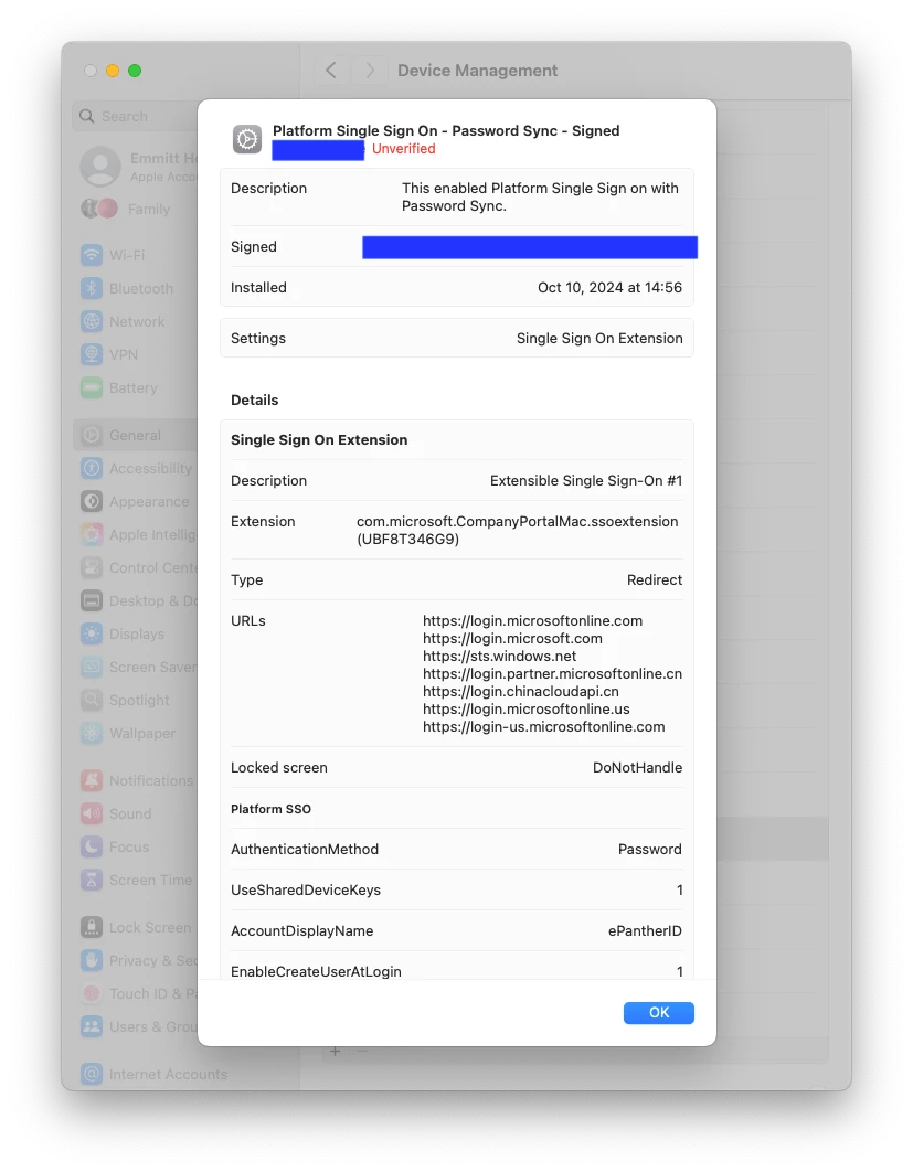

  • Nov 1, 2024 3:34 PM UTC
@rabbitt , thanks for posting this very helpful information.
We are facing some similar inconsistencies with our test deployment of PSSOe with password sync on Jamf Pro Cloud 11.10.1-t1728656858, using Company Portal Version: 5.2409.1 (53.2409926.002) and a signed config profile created in iMazing. We were experiencing some issues with the profile created in the Jamf UI, the session duration key value was being manipulated so, we went to a signed profile and didn't set that value, taking the default. We've still been experiencing what I would call a "drift" where, initially, things seem to work fine. After logging in, SSO works and the tokens are read, website and apps seamlessly connect as expected. Then after a few days or so, it may start with Teams displaying a banner that you need to sign in. Other sites that were previously, silently passing the SSO token, were prompting for login credentials and MFA. Our testing with SecureEnclave was must smoother but, due to our environment and culture at the time we have to start with password sync. I've tried to capture some logs using unified logging and some predicates but, I'm not sure what's "normal noise" or what's actually an error. Additionally, a line in the output of the app-sso platform -s command has been getting my attention but, I'm not sure if it's actually an error or if it's just describing what would be output in the event of that type of error. Under the "Login Configuration" section there is a key-value pair with the following:
"invalidCredentialPredicate" : "error = 'invalid_grant' AND suberror != 'device_authentication_failed'",
1. Any thoughts on the "drift" for Microsoft applications and sites that were previously taking SSO tokens prompting for credentials? (I saw your response to "wlumley" and we'll be checking with our Identity & Access folks regarding a conditional access policy if it exists or not.
2. Do you know of any good log predicates that may be of value to stream or look up when troubleshooting PSSOe w/ password sync?
3. Have you heard of or had any experiences with the Jamf UI when creating config profiles changing some values of the keys?
I think this particular one should have the wording changed and that might fix the issue since the key takes seconds but, the interface uses
resulted in:
So, the value entered in the UI was multiplied by 3600. The UI should say to enter the number of hours but, we got an error when entering "1". After this we didn't populate that key but, it still did not affect the issues we've been experiencing.
  • Nov 1, 2024 3:35 PM UTC
resulted in:
Forgot to post:
Here's what our current config looks like on the device:
  • Nov 1, 2024 3:38 PM UTC
Also, replace "session duration key" with "login frequency" woops.
mvu
  • Nov 1, 2024 3:40 PM UTC
resulted in:
Also observed the banner for Teams asking to sign in again. Saw earlier this week, but not today. Maybe an update or something came out for Teams.

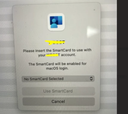

when we tried to use smart card method we are getting below error but we are trying to use Yubikey as smart card, why it is not detecting.
