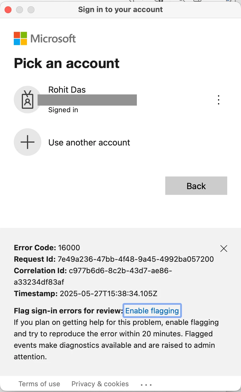

Hi All,
I am able to setup pSSO exactly like this guide, only issue is we are getting lots of sign in pop up like below and when trying to authenticate its getting stuck in between. The sign in pop ups comes with Error code 16000
