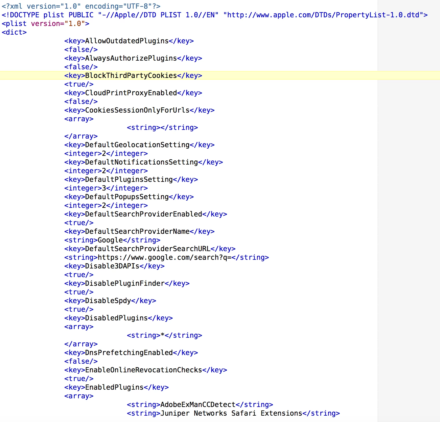

OK so here's the update. For one time only prefs you must create a file called Google Master Preferences found at /Library/Google/Google Chrome Master Preferences. It's a simple txt file in JSON format. More details at https://www.chromium.org/administrators/configuring-other-preferences . For this I just use Composer to package the file and deploy it when I image the computers. From what I can tell it only supports a subset of the available preferences ( they are listed at the end of the page ). Like I said previously this will ONLY give defaults prefs the first time chrome is run and they are NOT locked just friendly suggestions. For the real good stuff, I deploy a Configuration Profile (Computer not User). Per JAMF's recommendation they suggest only using one configuration profile per set of preferences so mine is ONLY dedicated to Google Chrome settings. To create the settings you must create a plist file called com.google.chrome.plist. In this file I put all of the settings that must be locked down and NOT changeable by the user. The complete list of available prefs is located at https://www.chromium.org/administrators/policy-list-3
When you construct your plist it must be in the right format, see my screenshot above. Once applied via configuration profile the changes are instant. You can verify that the prefs have taken hold by typing in chrome:policy in the address bar, it will then show you a list of all the prefs that have been applied.

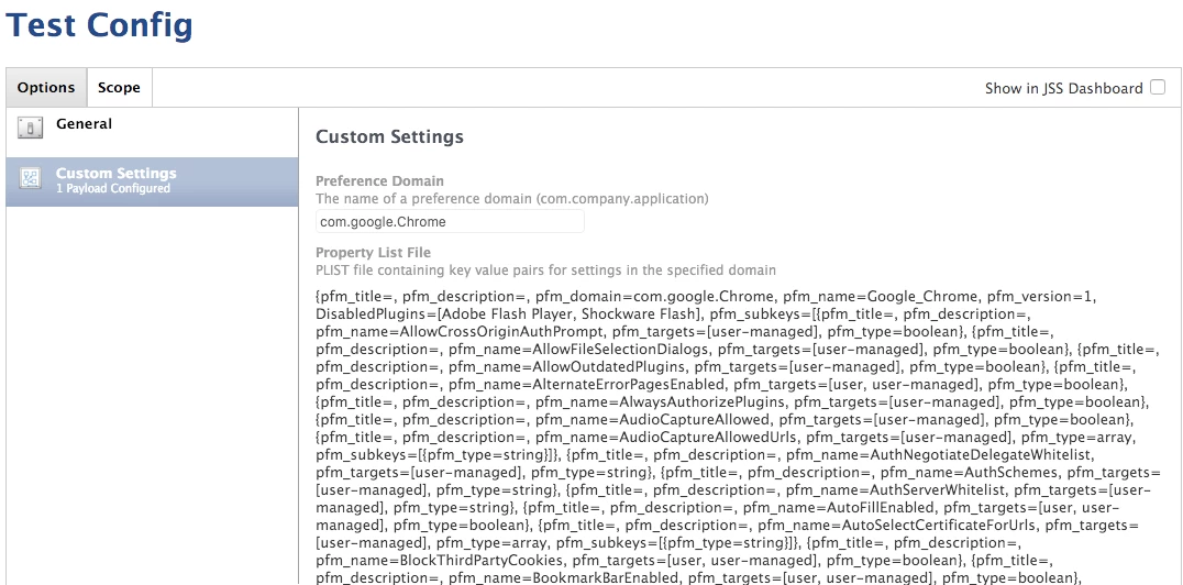

@maxbehr Hi Max i've been following your method by deploying a configuration profile, and it's a great success. so i've deployed a bookmark folder to user chrome without hurting their existing bookmark. but one question, it seems i can't change the name of "Managed Bookmarks", even though i tried add <key>name</key>
<string>test</string>
at the end of dictionary, but its name still Managed Bookmarks, didn't change to test. you have any idea how to change it?

@maxbehr Thanks for your hard work on this. Can you tell me where this com.google.Chrome.plist file needs to live on a computer? I've built the plist using Xcode and now I want to test the plist before deploying it with a configuration profile. Also, will this overwrite the rest of the settings in user's plist configuration? I just want to block some plugins using your method you've described.
Thanks!!
  • Mar 23, 2016 11:52 PM UTC
@danhutchings, When using managed preferences / configuration profiles the file is placed in /Library/Managed Preferences so you should be able to put it in /Library/Preferences or in ~/Library/Preferences to test. Like most managed preferences the settings are additive to any settings the user has already set UNLESS you are overriding something that the user has set, then the managed preferences or /Library/Preferences take precedence over ~/Library/Preferences

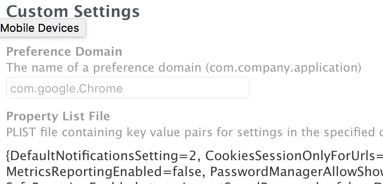

  • Mar 25, 2016 9:22 PM UTC
I was able to upload the file now! So that is a plus. However, when I upload it, it just gives me the attached screenshot. Let me know what you think.
Thanks!
  • Mar 31, 2016 5:02 PM UTC
Sorry for the delayed response, That is indeed odd. If I had to guess the plist is malformed in some way. Could you try copying and pasting the text into your response so I could see the raw plist?
