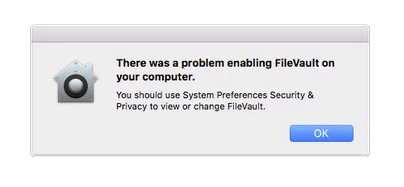

@el2493 do you have any jamf policies running that change/reset the original admin user password created in Setup Assistant? I ran into a similar issue earlier this week, I just joined an org that uses a LAPS script in a policy that changes the local admin account pw. Saw weird issues where secureToken was "stripped" from the user after previously shown as enabled for secureToken. A breakdown of the 2 scenarios is on my GitHub: https://github.com/ducksrfr/LAPSforMac
Example error I was getting when attempting to enable FileVault:
