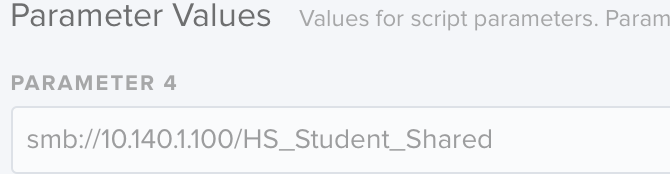

Asnyder
Thank you for your post. I found a similar script before but was not sure where i add the smb://path/directory ...
Am I right assuming that i need to change there Share path instead of the g?
/smb:/g' -e 's/\\///g')"
  • January 12, 2018
under script parameters in jamf you put in in parameter 4.
