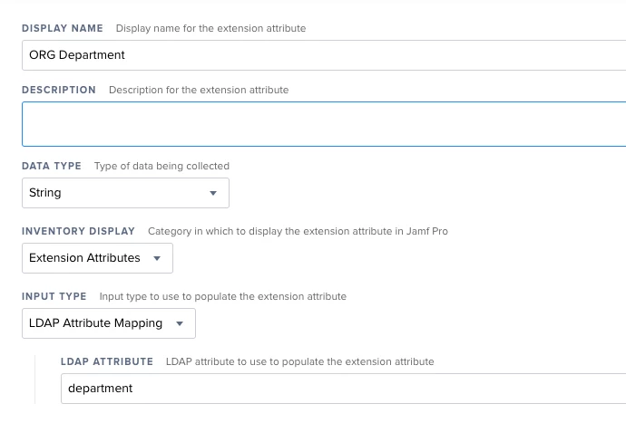

Interesting thing though... When I map Phone=department or Phone=l (or Email Address=department or Email Address=l, etc.) it maps department or building into the Phone (Email Address) field correctly but when I map Department=department and Building=l (as a matter of fact if I try to map anything there) those fields stay blank as on @daniel_ross screenshot. Could it be jamf not Okta?
aesin
  • January 28, 2019
To be able to create smart groups using departments with jamf not being able to display those values properly, I have tried to create an extension attribute as below and it worked. Now when I go to the extension attribute tab within a computer record I can see a proper value there.

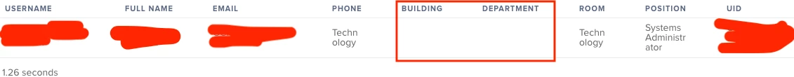

The only trouble I am having is the user record does not pull in Department and building and I have followed your settings above. any suggestions?

@wmateo if you have the correct attributes in the mappings tab of the LDAP server (Okta), then my guess would be that you are trying to pull in building or department names that do not line up with what you have in Jamf. Both Department and Building have to be spelled exactly the same as you have in Jamf.
For example, if under "Settings -> Network Organization -> Departments" you have "Executives" but in AD you have a person's department as "Executive" it will not populate from Okta. The two have to be indentical. This is also true if you're trying to set these values from the machine using the jamf recon -department <department> call.
So my first check would be to make sure you have the spelling identical in AD as it is in Jamf.

  • July 10, 2019
Hi guys,
I have setup a new LDAP server with Okta in our JAMF Pro. The server is being setup correctly and I have tested and it is populating the user's correctly.
But the issue is with few attributes that are not populating in JAMF which are : Building and Department.
No matter what I enter it doesn't display anything. Also, if I map same attribute in other field it shows: eg. I mapped Room with department and it is displaying Department.
Anyone else facing any similar issue? or know what could be wrong here?
Thanks,
  • July 10, 2019
@gchadha1 It's been a month or so since I tested this but I believe the Building and Department names need to be configured in Jamf first (and they need to match what you have in Okta) before they will be displayed there.
