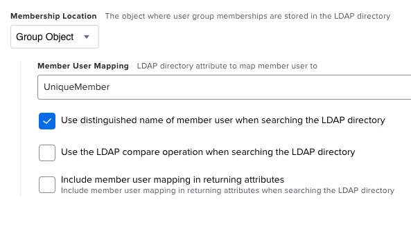

For anyone experiencing issues where Group Membership is not working correctly, the "Member User Mapping" setting in "User Group Membership Mappings" should be "uniqueMember" and not "UniqueMember":
https://help.okta.com/en/prod/Content/Topics/Directory/LDAP-interface-connection-settings.htm
For us, this was causing LDAP tests to show users as members of groups but signing into Jamf Self Service via SSO was not returning the correct group membership for LDAP Group filtered policy scoping.

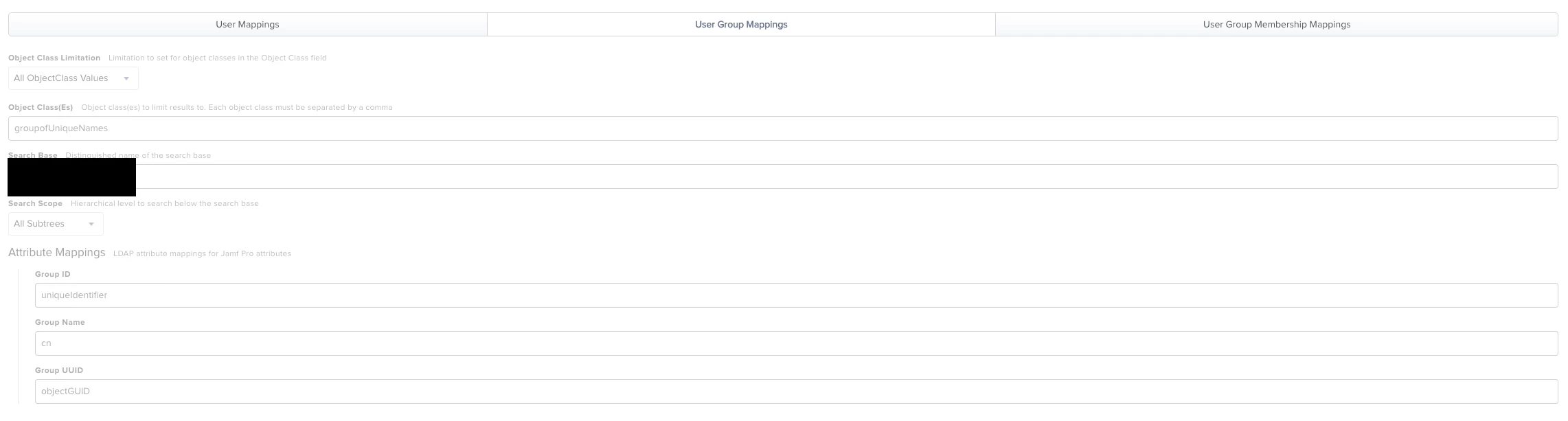

User Group Mappings doesn't seem to work properly for me. When I enter a user to do a test/search - I don't get a list of all the groups that member is apart of.
When I use User Group Membership Mappings and test User to a Group works.

For user group mappings this works for me

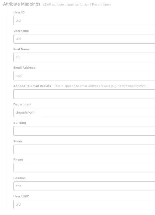

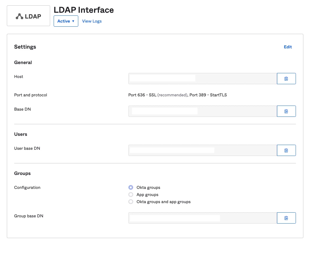

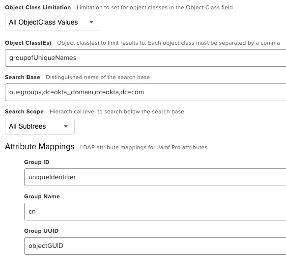

A quick write up of how to get this setup and working top to bottom since I can't find anything on this:
Enable Directory Integration in Okta Admin
You will need to login to the Okta Admin portal and under Directory > Directory Integrations you can create an LDAP Interface. You should see something similar to below, we will come back to this later.
Create Read Only Admin Service Account in Okta
You'll now want to create an account in Okta that will be used as a service account for Jamf to query LDAP with. This user account should have Read-only Administrator permissions delegated to it in Okta.
Setup LDAP Server in Jamf Pro
In Jamf Pro go to Settings > System > LDAP servers and click New then Configure Manually
In the Connections tab
  • Enable the Use SSL box and in the Host field enter the domain from the Host field shown on your Okta LDAP Interface page (Should be domain.ldap.okta.com)
  • Enter 636 in the port field
  • Authentication Type should be set to Simple
  • LDAP Server Account
    • Distinguished Username should follow this convention "uid=ldap_account@domain.com,dc=okta_domain,dc=okta,dc=com"
    • Enter the password for the Okta Service Account you created before
    • Connection Timeout should be 15 seconds
    • Search Timeout should be 60 seconds
    • Referral Response should be "Use default from LDAP service"
    • Enable Use Wildcards When Searching
In the Mappings > User Mappings tab
  • Object Class Limitation should be set to All ObjectClass Values
  • Object Class(es) should be set to inetOrgPerson
  • Search Base this will always be in the following format
    • ou=users,dc=okta_domain,dc=okta,dc=com
  • Search Scope will be All Subtrees
  • Attribute Mapping will be:
  • User Group Mappings - Replace okta_domain with your Okta domain
  • User Group Membership Mappings
  • After that click Save and then Test to do a user lookup and see if it works.
