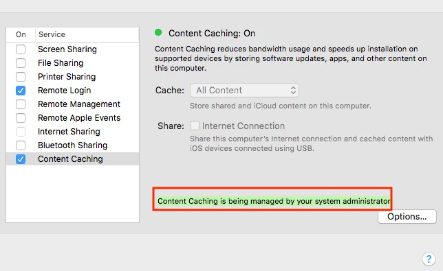

Content Caching is being managed by your system administrator.
  • April 12, 2018
  • 13 replies
  • 144 views
Hello, is anyone else seeing the Content Caching pane getting locked down when applying a Restrictions payload with 'Allow Content Caching' checked?

Yes. I have this same issue and it's causing me a lot of trouble.
Prior to 10.13.4, the restrictions profile with "allow content caching" checked would unlock the options in the Pref Pane, but as of 10.13.4, everything is greyed out, even with the profile installed.
I tried using terminal to set a parent (as per this article: https://support.apple.com/en-ca/guide/mac-help/configure-advanced-content-caching-settings-mchl91e7141a/mac) and it actually broke the Sharing pref pane so that it wouldn't open. I had to delete the AssetCache plist & reboot in order to get the pref pane to open again, but unfortunately, this disabled caching so I had to re-enable it again...

  • October 14, 2020
I completely forgot about this post until I bumped into this issue again today... I'm on jamfPro 10.23.0 server with a macOS 10.15.6 client.
An admin was getting "Content Caching is being managed by your system administrator." in System Preferences despite a MDM profile with Restrictions --> Allow Content Caching being set to true.
The fix for me was to delete the allowContentCaching key pair from the MDM profile.
<key>allowContentCaching</key>
<true/>
Perfect example of a ternary key... different behaviour in macOS for true, false, and unset. Hopefully, PI-004822 will get fixed someday.
  • November 3, 2020
We're seeing this issue in 10.23.0 as well but I am not clear on the solution that works for you Sonic84. Can you provide more info? We have multiple restriction profiles in our environment but all of them are configured to allow content caching; and while we can turn caching on, we are unable to adjust the Cache content type or Share the Internet connection as the settings are grey and we have the message "Content caching is being managed by your system administrator.
Despite the Preference settings being locked down, it seems adjustments can still be made via terminal, so if you're only concerned about disabling the iCloud portion than the command below would configure for "Only Shared", which I believe is apps & updates
sudo -u _assetcache defaults write /Library/Preferences/com.apple.AssetCache.plist AllowPersonalCaching 0
