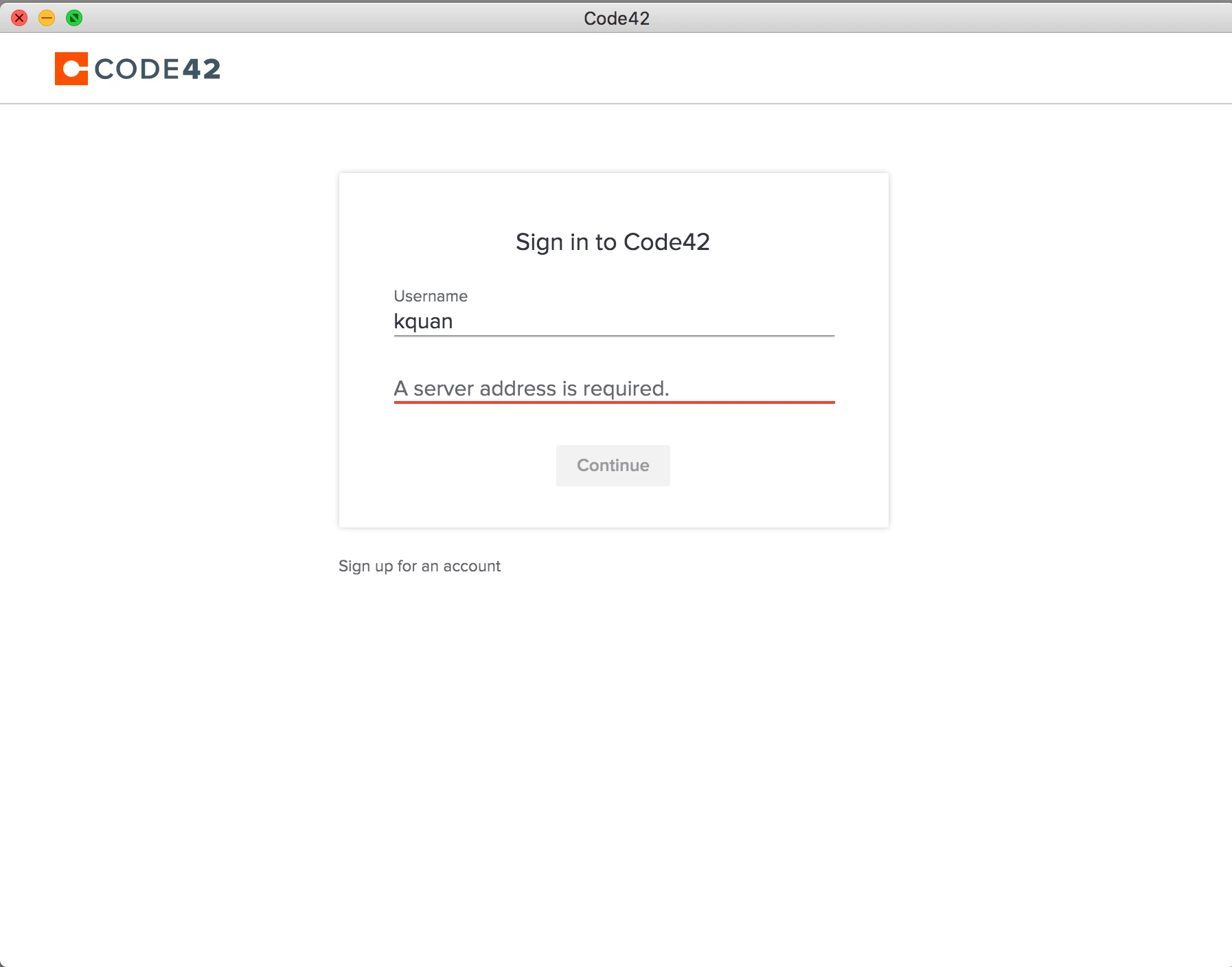

Hey Guys!
I have followed @spreston's method of deploying CrashPlan in a Self Service policy
However even when using the deploy.properties which does contain the URL specified, after launching the App, it does know the username, but still asks for the Server Address.
Does anyone know how to complete the autofill for the Server Address portion?

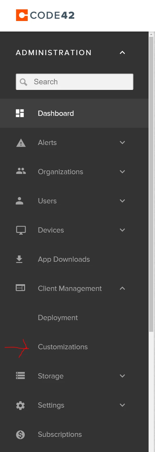

Do you have a "deployment" setup in the CrashPlan console? Starting with v6.5 they completely changed how things work... Worth checking out at least. :)

@mbezzo Just got my Code42 access. I'm an admin in the console, but dont see a "deployment" setup
  • May 17, 2018
This is what I see in my console. If you don't have all these tabs on 6.5 server then you may be missing a permission?
