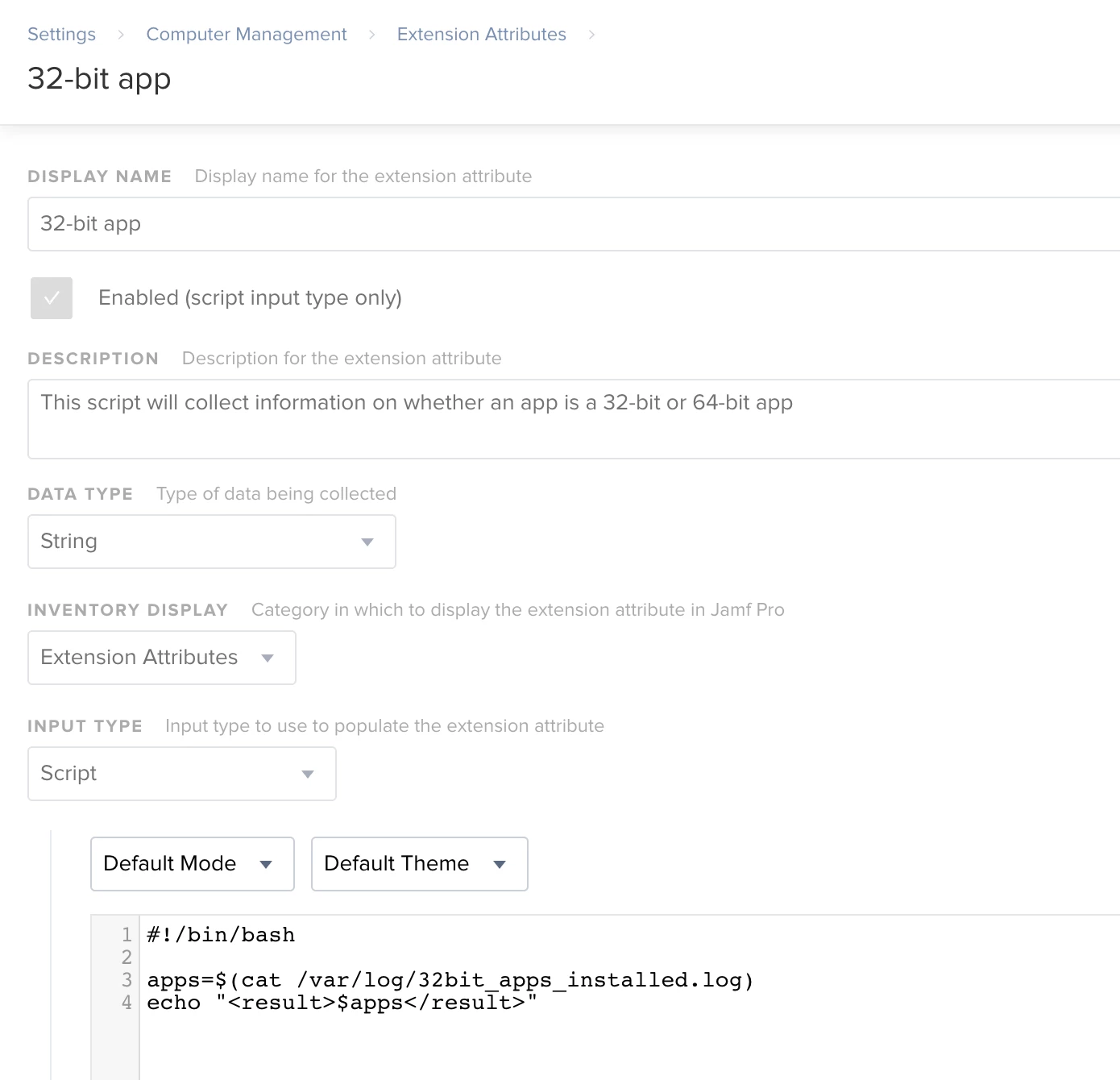

You could push out the "detect_installed_32_bit_apps.sh" via a policy to all computers so that it writes the apps to /var/log/32bit_apps_installed.log, then create an Extension Attribute with the following as the EA script:
apps=$(cat /var/log/32bit_apps_installed.log)
echo "<result>$apps</result>"
Then you could obviously create a report based on that once the results are in your inventory.

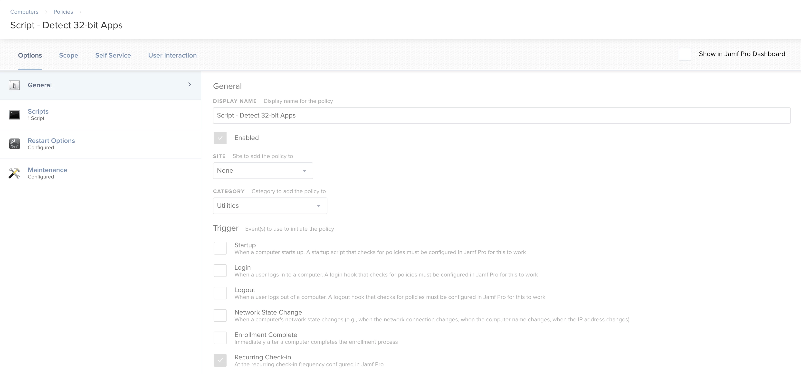

1. Create the "detect_installed_32_bit_apps.sh" script under Computer Management > Script. The author is Der Flounder. He publishes a lot of useful materials on Apple stuff.
2. Create a computer policy with the "detect_installed_32_bit_apps.sh" script & Update Inventory
3. Create an extension attribute with the input type as Script and copy the script above from @amccarty

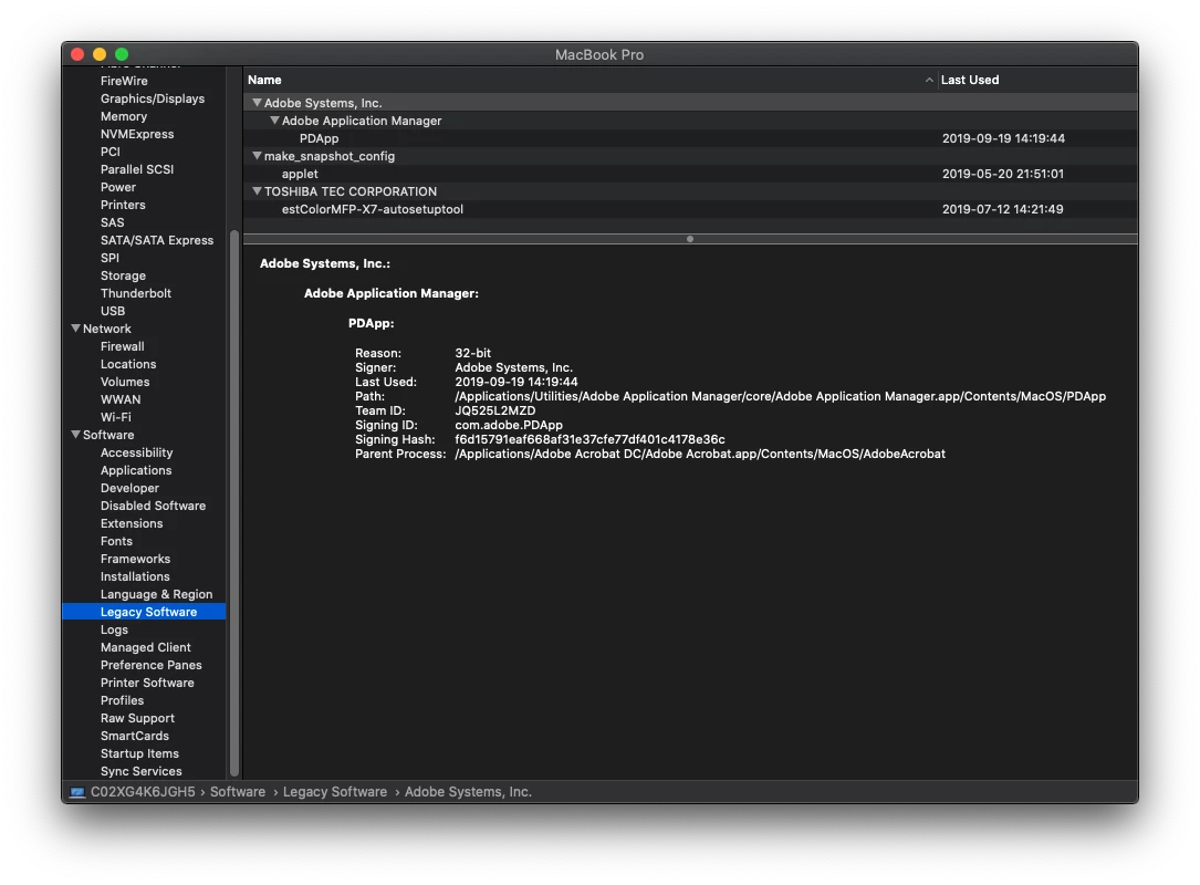

You can also check out Legacy Software in System Profiler

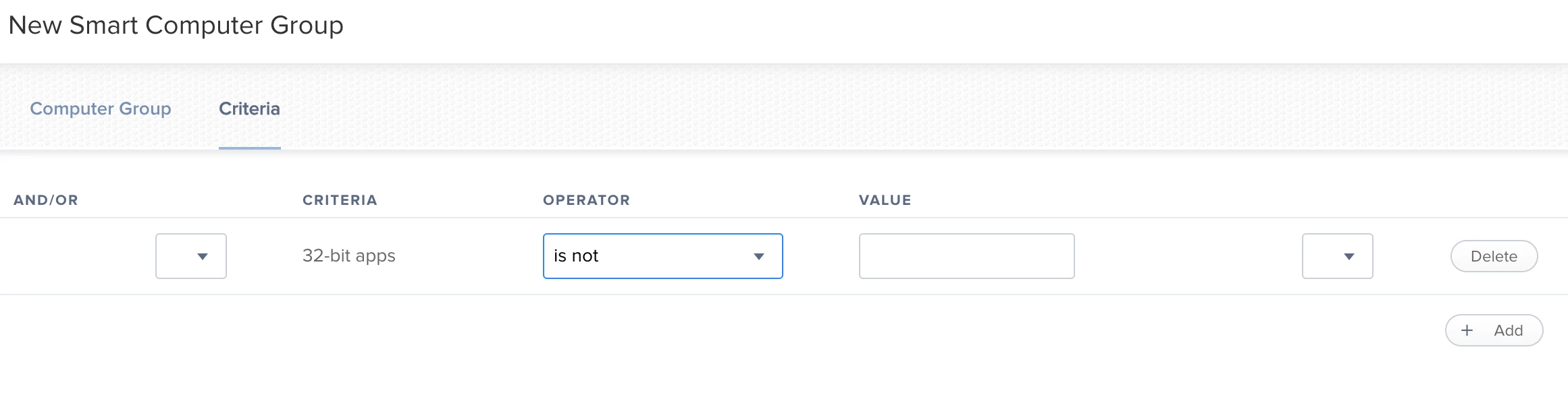

Hi @amccarty @hphan thanks this has been great help. I am new to Jamf Pro and this is my first upgrade cycle.
I have followed the instructions below, however I can’t figure out what criteria to use for the new Computer Smart Group.
I thought I could just select the 32-bit apps EA but then what argument do I use in the operator and value fields?
32-bit apps | is not | ????
![optional image ALT text](
amccarty
  • October 30, 2019
@acekicker77 I take it you're trying to create a group which just adds computers with any 32 bit app installed?
If you leave the operator as "is not" and leave the value blank, all computers with 32 bit apps installed will be added to the group as their "32 bit app" EA record will not be blank in the inventory.
If you're trying to be more specific and find Apps you already know are 32 bit, set the operator as "is Like" and put in part of the app name, e.g "Adobe Application Manager", and it will add any machine with that particular app installed to the group.
