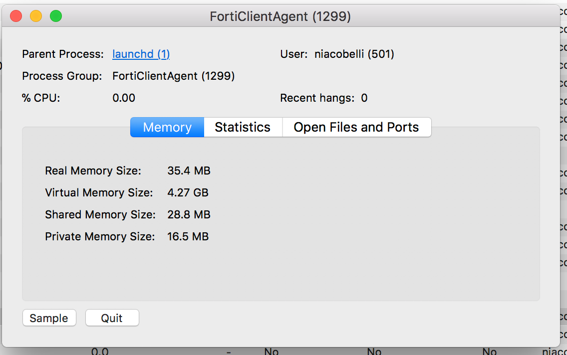

In activity monitor FortiClient is running as the logged in user. There are FortiClient LaunchDaemons and LaunchAgents so its running as root and the logged in user.
So is it as simple as running at command in jamf to reload the daemon/agent?

It's likely the LaunchDaemon is running one part of the Forticlient process, and the LaunchAgent is running something user facing, like the icon at the top of the toolbar that you referenced in your first post.
So, if you need to relaunch the LaunchAgent, the above launchctl load code by itself isn't going to work when run from a policy, because policies run as root, and it would attempt to load the LaunchAgent in the root account space, which it can't do.
For this, I would use launchctl asuser, possibly first to see if the agent is running, and then to launch it if it's not already running and needs to be.
Here's a sample script, but you will need to determine the exact process name that shows up in the command line and plug that in, as well as the LaunchAgent file name. I don't use Forticlient so I don't know what either of those are. Is the FortiClientAgent name in your screenshot the actual user facing process? If so, you would use that in the ForticlientProcess section below.
