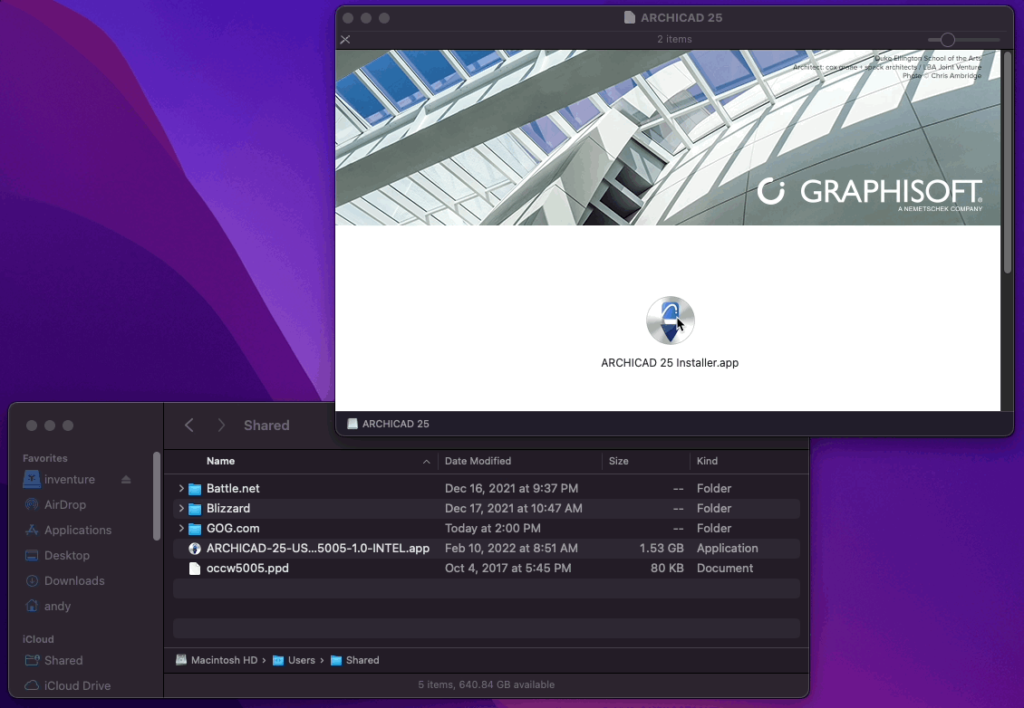

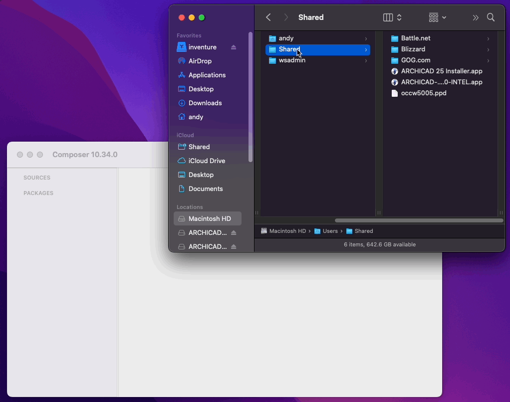

I finally figured out how to do this.
So if there are other Archicad Users out there... enjoy! Just thought I would share this since I couldn't find any posts on how to do it.
I will be using Composer & Archicad 25 Full Installer 4013 for Mac.
/Users/Shared/ARCHICAD\\ Installer.app/Contents/MacOS/installbuilder.sh --mode unattended

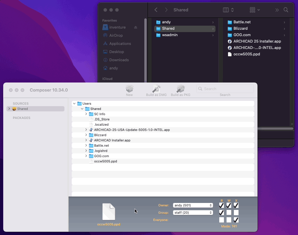

    • Paste it below these lines. Remove anything else.
## postinstall
    • Save
  • Rename your Source as Archicad 25 - Base Install 4013
  • Click Build as PKG. After a few minutes you will have a pkg that will install Archicad.

Looks good. However, I have one piece of advice for ya. You don't need to drag the whole /Users/Shared/ folder into Composer and then delete the unwanted stuff. If you just drag the installer from the Shared folder into Composer, Composer will automatically follow the full path without all the other stuff you may have in there.
