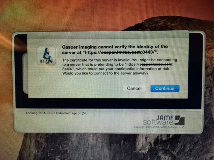

I have used AutoDMG to create a DMG file from latest Yosemite installer. Have then taken the DMG and ran it through AutoCasperNBI, ticking the 'Create A Restorable DMG' option. We are currently running Mountain Lion across the board and ACNBI never finishes, so I ran it on a factory Yosemite machine and it pops out a restorable DMG, as it should. However, imaging with USB created from this continuously prompts that the Casper server it is connected to may not be the true Casper server. It seems to be asking for a certificate of some type? I have watched ACNBI run its process, it appears to grab this from the Casper server that I defined in the initial setup. Has anyone experienced this? Is there a way to make it stop asking? It has to be acknowledge by clicking ok or cancel and stops the build while waiting for an answer. I will grab a screen shot when I can. Again, is there a better way/process for creating the image for the USB?

@ Freddie.cox Yes, this is exactly what I did. However, when I launch Casper imaging it starts to pop up messages that the server may not be a real Casper server and that it requires the certificate. As I stated above, I saw the portion of the image build where it called for the cert and it did it, so I am not sure why, during Casper imaging launch or during imaging it pops this error message.

@davidacland I have tried as you suggested and everything went smooth...until I launch Casper Imaging and get the same certificate message that the server may not be trusted.
Question, when CI is launched, it asks for the URL of the Casper server, and has a check box for 'trust certificate from untrusted source' or something similar to that. Should this be checked or unchecked?

@davidacland I tried both ticked and unticked. Same result. Certificate warning message each time at some point during the build.

@MTurnerFMRCO this sounds like a different problem I've seen. Do you mean it happens mid-imaging / deployment? Could you post a screenshot?
  • June 23, 2015
@davidacland The issue happens sometimes as Casper Imaging loads and sometimes right before a reboot occurs in the build process, towards the end of the process.

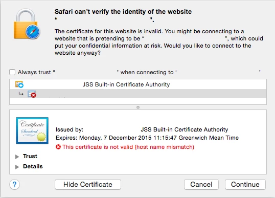

You can check if you have a self signed SSL cert by connecting to your JSS in a web browser and checking the https certificate. It would look something like this
  • June 24, 2015
@davidacland That could very well be possible, not sure as this is my first attempt at boot media and apparently the first Yosemite boot media to be created. I am using Casper Imaging 9.4. Possibility of trying a newer version of the Imaging application?
Cert appears to be self-signed.
