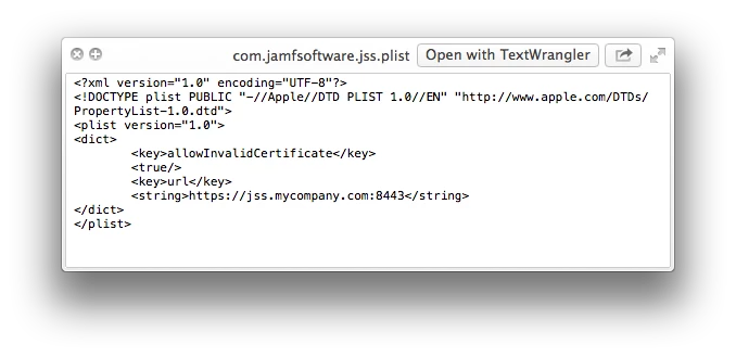

I was having a nose at AutoCasperNBI & it's grabbing the JSS's CA cert.. Not the Tomcat cert.
If you add the "internal cert" as an additional cert to AutoCasperNBI... It should work, as in the created image should have the cert trust in there as needed.
Actually, I think this maybe a Casper Imaging issue.
By default, AutoCasperNBI will set Casper Imaging to ignore Invalid certs if a JSS URL is passed to it:
If Casper Imaging is not honouring that, then it's a bug with Casper Imaging.
If a JSS URL is not being entered into AutoCasperNBI then it's still a Casper Imaging but as Casper Imaging will not honour the "allowedInvalidCertificate" key. (FR)
