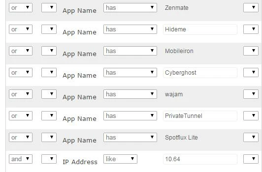

Hi we have a smart group setup to 'lock' ipads with VPN's installed, problem is it appears to block them when outside of the school, we have Clustering setup and working so devices are getting info / checking in from external. we have the following rules / criteria in the group. various vpn app names using OR app name HAS betternet (name of app) we have about 15 of theses rules so far) AND ipaddress LIKE 10.64 so in theory any ipad with one of the listed ~VPN's installed and is on the school network should get the restrictions, BUt it appears to be blocking outside of the school ip range? do i need to put brackets around the ip address?
any ideas?
