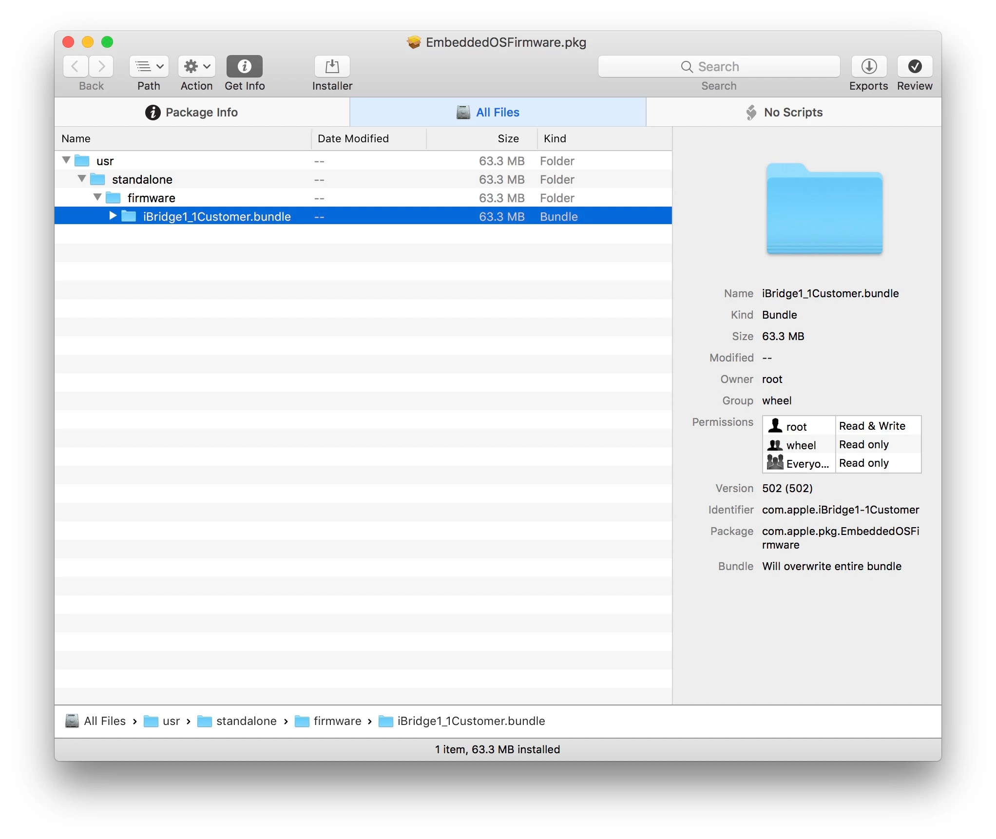

Perhaps it's something in DeployStudio doing it? We're using Casper Imaging, and just imaged more machines today with no issues.
The bundle in question is also the only thing Apple ships in its EmbeddedOSFirmware.pkg that comes along with 10.12.3:
