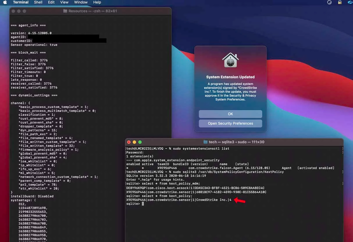

I'm having the same issue.... but only on machines that start on BigSur. -- Machines that have Catalina installed, then upgrade to BigSur, do not receive the prompt for systemextension update.
I suspect it's related to how BigSur is handling kext_extension trust vs. those inherited via MDM, and how CS 'reconfigures its self'
I also used the demo profile from CS as my template...
The Catalina -> BigSur machines do not have this pesky little '4' in the kext_policy table, but those that start on BigSur do...
I've definitely been beating my head against the wall on this 'prompt to allow update' nonsense....

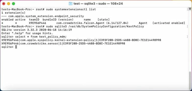

@mallen13
Interesting. I haven't testing applying the profile to 10.15 and upgrading. All my testing has been done on Big Sur. I checked mine and I don't have the mystery 4.
  • January 21, 2021
The kext_policy_mdm table doesn't have the mystery '4' -- but the kext_policy table does. ( inherited )
Oddly enough, the upgrade from catalina machines are NOT having any issue as long as they had the config profile ahead of time... it's the ones STARTING on BigSur that do...
There was another post ( https://www.jamf.com/jamf-nation/discussions/37623/falcon-sensor-system-extension-approval )
that suggested completely separating out KEXT from SYSEX from PPPC etc.... which makes perfect sense...
Especially since the M1 machines absolutely HATE LIFE when you have anything legacy in a cfg profile...
I'm going to see if separating out KEXT/SYSEX solves the issue...

Q. The sql information output, I'm guessing that is kernel extensions and not system extensions?
I ask because I just removed the kernel extensions from my profile, applied the profile to the system, rebooted. Installed CrowdStrike, within 10 seconds of it installing, I disabled network and let the system idle. Not prompts, Falcon is running. When I checked systemextensionsctl list I see the System Extension. When I run the sql commands, I see nothing listed which if these are kernel extensions, that's expected. Enabled network again, wait, 1-2 minutes usually but sometime longer but eventually the prompt comes up that System Extensions have been updated... Run systemextensionsctl list again, no obvious change from that output. But running the sql commands again I now have entries in there. This last go mine had a 20 at the end, not a 4. So is CrowdStrike still trying to load kernel extensions once it's talks back to the cloud? I'm just guessing here.
  • January 21, 2021
Well... so I guess that is the mystery then...
the dreaded "To finish the update, you must approve it in the Security & Privacy System Preferences" dialog is my arch-enemy at this point. - CS does do an update via it's own client.... but even though it's "trusted" -- it still produces this bleemin' dialog.
( on BigSur only.... Catalina seems to work as designed, and does not prompt... )
When I find a solution, I will certainly share it here... -- this is driving me CRAZY.... :-)

  • January 21, 2021
@mallen13
I have a video of it but can't upload it here. :( But if in fact the output of sqlite is kernel extension related, isn't the problem with CrowdStrike as on Big Sur, their client should be using System Extensions ONLY and not attempting to do anything with kernel extensions?

  • January 27, 2021
I think I've got literally every other key in there except my profile is set true here...
" <key>AllowUserOverrides</key> <false/>
Thanks! -- will dig into/try this.
  • January 27, 2021
That key, in both the System Extensions and Kernel Extensions payload/sections, was the only change I made to CrowdStrike's profile. What's so terrible about this is that pretty much any app you can use to build profiles doesn't recognize the Kernel Extension or System Extension payloads, so you're forced into manually editing and referring to Apple's developer docs to make sure you're not breaking something.
