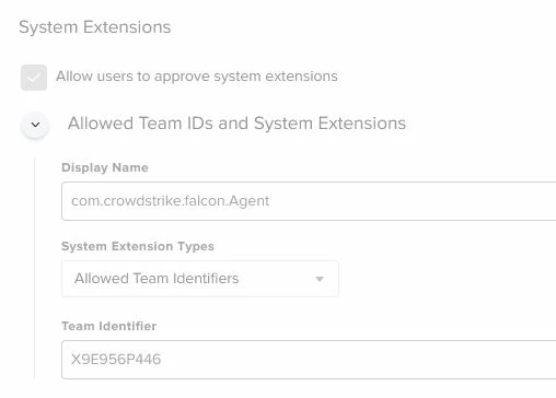

Hey JAMF.... feature request: change "Allow Users to approve system extensions" to: "Prompt Users to approve system extensions" :-)

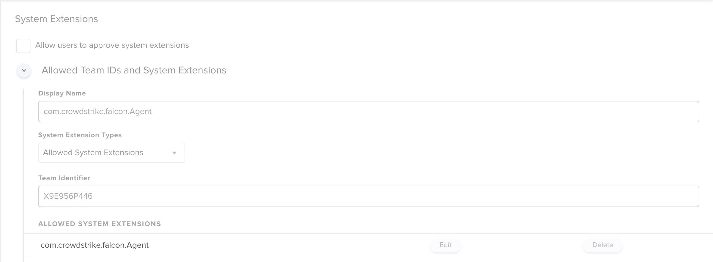

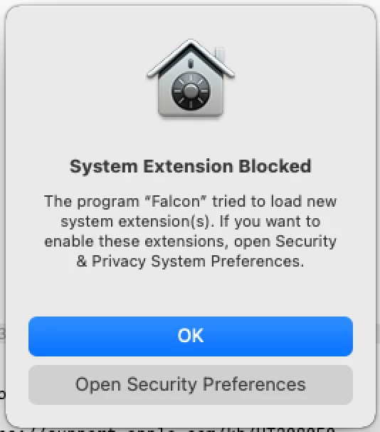

So it was a combination of things...
Removing the check-box for 'Allow Users to approve system extensions' helped... but the final nag was, indeed, the 'BIOS/Firmware Standard Visibility' -- I managed to get our Sr. CS admin to DISABLE this feature in my test group, and now there are no more KEXTs in play. -- no prompts...
  • January 28, 2021
@mallen13
Also confirmed on my end. Disabling the BIOS/Firmware feature has resolved the additional prompt to approve the KEXT. CS support is now aware of the issue but unsure if they can work around it.
I need to spend some time now building out the configuration profiles separately and testing again to confirm.
  • January 28, 2021
@mallen13

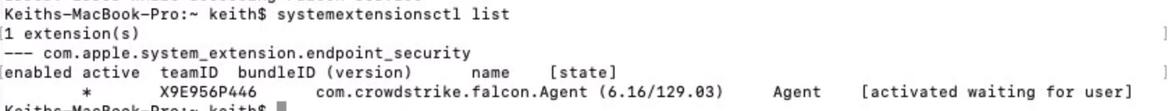

So unchecking the "allow users to approve system extensions" actually worked? I don't have the Firmware / BIOS Standard Visibility enabled, so I'm not hung up on a kext but I still am getting prompts to enable the system extension.
Even running
systemextensionsctl list
shows me that the system extension is "loaded" but waiting on user approval, which I want to avoid.
What version of CS are you running that played nicely for you?

  • January 28, 2021
@KBNet
And just cause I'm all setup for this, I snapped my vm back and retested with "Allow users to approve system extensions" enabled in the above System Extension profile and tested, no prompts again. In the CS provided profile this option is selected.

Thanks for the details. Was this on a fresh install of Big Sur? I am attempting to upgrade machines. specifically from varying versions of macOS (Mojave and Catalina are really the two big ones).
My process is: upgrade CS from 6.15 to 6.16, install the profiles prior to upgrade (no prompts received on old macOS versions), upgrade straight to Big Sur, wait the 30 minutes to only be devastated by the "System Extension Blocked" pop-up after the upgrade.
I feel like I've been through absolutely everything to try to figure this out, and I can't. I just want to confirm, with the profiles you have your users are not seeing a single prompt (i.e. the one above)?

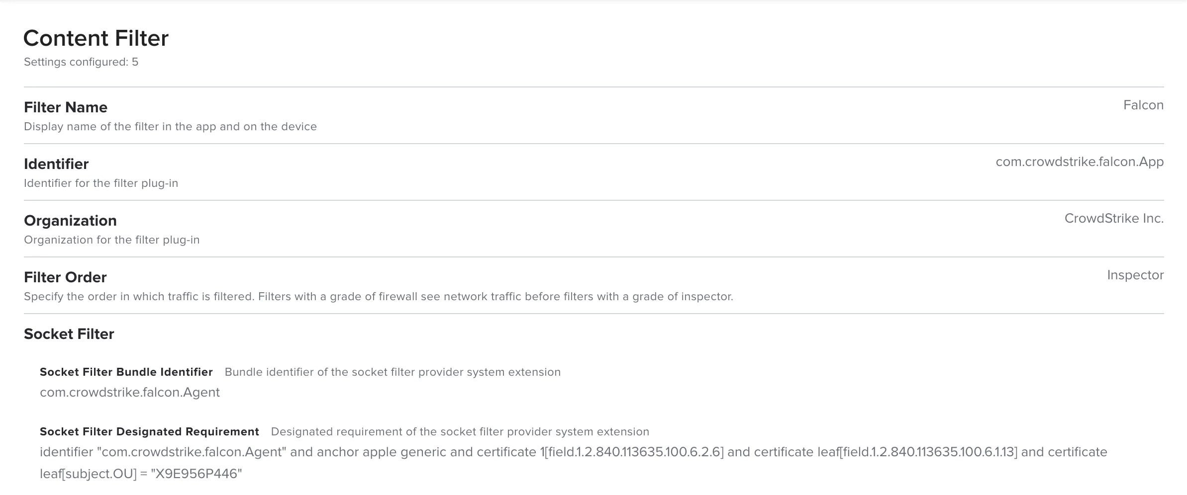

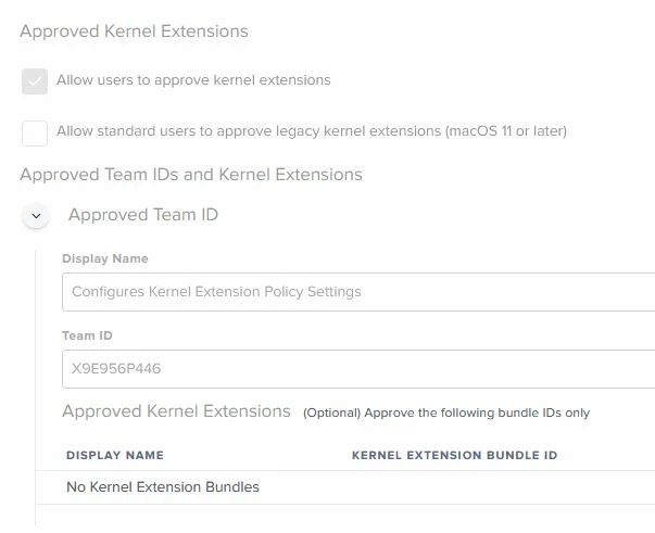

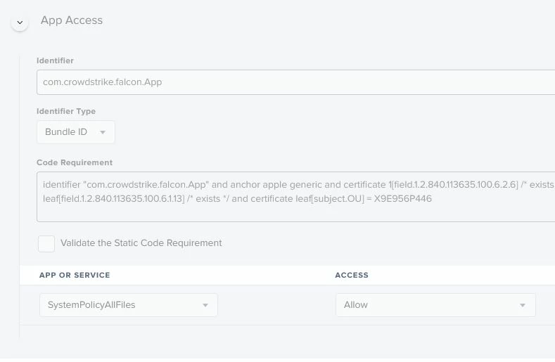

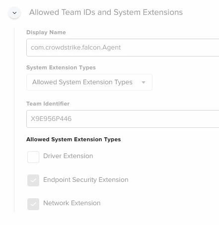

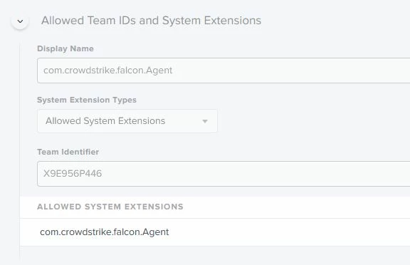

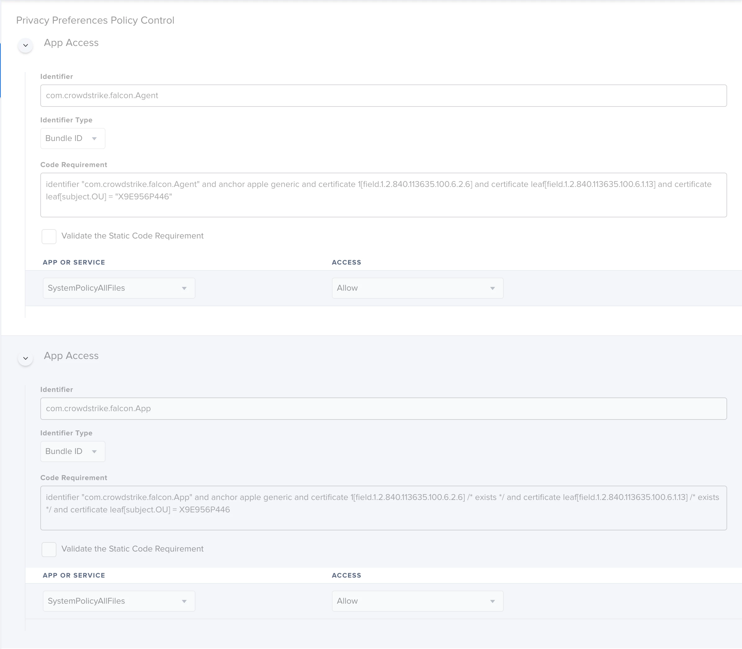

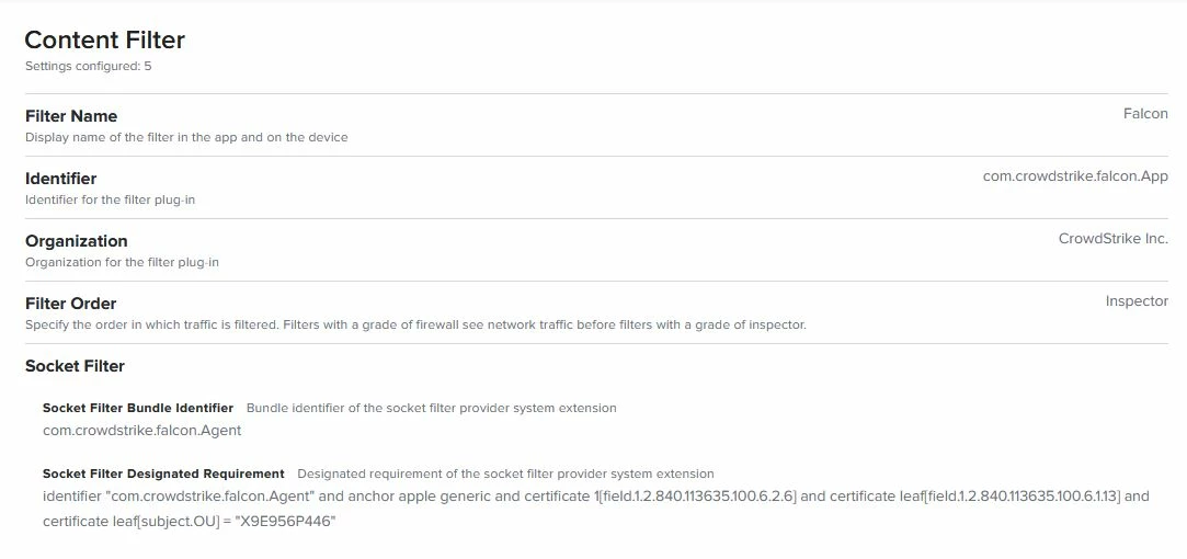

I have also decided to abandon the CS profile and roll my own. The system extension from what I can tell is identical to yours, and I still get the bloody prompts.
PPPC:
Content Filter:
System Extension:
Ultimately, after running the cmd to show the loaded extensions, I see that it is there and activated but for some reason waiting for the user, which I want to avoid.
We don't have firmware analysis on so a kext isn't needed either.

I feel like my scenario of installing CS then upgrading to BS might be the cause here. I think it might be time I roll up a fresh install of Big Sur and see if that works, rather than an upgrade. If that's the case though, I'm not quite sure how we're going to handle the plethora of machines not running BS.
Have you had an upgrade path work with CS and Big Sur with this profile, where users are not required to approve the system extension?

I suspect your issue is the upgrade and you are having any number of problems. Notice the prompt is mentioning Falcon instead of CrowdStrike Inc? I believe this is because in 10.15 and earlier the process for CrowdStrike is falcond but in Big Sur the process is called com.crowdstrike.falcon.Agent. It's also possible that even though the profile was installed in 10.15, the system extensions aren't used and therefore aren't installed/linked or whatever happens in the backend. When you upgrade to Big Sur they can't load or something. Perhaps try applying new profiles once you upgrade to Big Sur? But then you'll also have the falcond vs com.crowdstrike.falcon.Agent issue until "something" triggers that switch, 30 minutes later?
Have you checked to see if "falcond" is actually a KEXT and not a System Extension?

Just an fyi, if you load the system extension payloads whilst on Mojave and then upgrade to Big Sur the system extension payloads will not be recognised hence the "Falcon" prompts.

I've now completed some macOS upgrades and to my surprise I haven't been prompted after upgrading. ??? This wasn't expected.
My profiles, all are separate scoped to the appropriate version of macOS.
CrowdStrike Content Filter - Scope = macOS 10.15 or later
CrowdStrike Kernel Extensions - Scope = macOS 10.13.2 to macOS 10.15.x
CrowdStrike PPPC - Scope = macOS 10.14 or later
CrowdStrike System Extensions - Scope = macOS 10.15 or later

Has anyone been able to get the PPPC portion of the profile to work? I'm not getting any prompts for the system extension surprisingly. But i'm unsure if the PPC is actually working. When running:
sudo sqlite3 /Library/Application Support/com.apple.TCC/TCC.db 'select * from access'
the com.crowdstrike.falcon.agent nor the com.crowdstrike.falcon.app are showing up as been given access.

I get no prompts for anything including PPPC as per my config/settings above in any OS now. I have not tested Big Sur on M1.

@ubcoit Yeah i'm not getting any prompts at all, but i'm unsure if the PPPC policy is actually working. Anyone know how to test FullDiskAccess for crowdstike? we just opened a ticket with them, hopefully we can get them on the phone soon to figure out what the expected experience should be.

Ya, that's a fair point! I have no idea if the software works but it installs now, runs and doesn't prompt me. lol

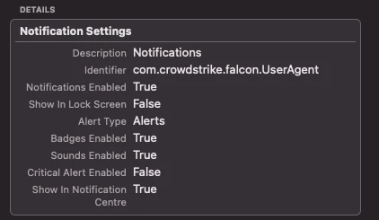

How are you guys suppressing Falcon Notifications prompt? I see no one talked about this on any other threads.
You guys are getting a prompt to approve or deny Notifications for Falcon?
  • February 19, 2021
@danny.gutman Use a profile editor of your choice and then decide how you want it handled
