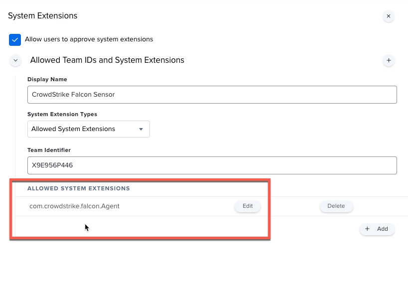

We were able to get Crowdstrike to install and bypass the system extension prompt by adjusting the profile to specifically target the System Extension (com.crowdstrike.falcon.Agent) as opposed to just allowing all system extensions from their team identifier.
