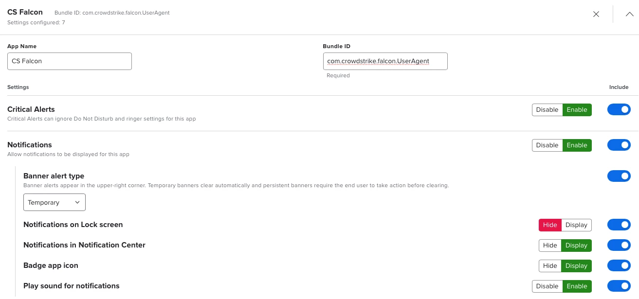

  • Jul 15, 2021 9:17 PM UTC
How are you guys suppressing Falcon Notifications prompt? I see no one talked about this on any other threads.
You guys are getting a prompt to approve or deny Notifications for Falcon?
CrowdStrike calls it notifications from a second app hidden in the app bundle.
/Applications/Falcon.app/Contents/Library/LaunchServices/Falcon\\ Notifications.app
Use the Bundle ID of "com.crowdstrike.falcon.UserAgent" in a Notifications Configuration Profile.
