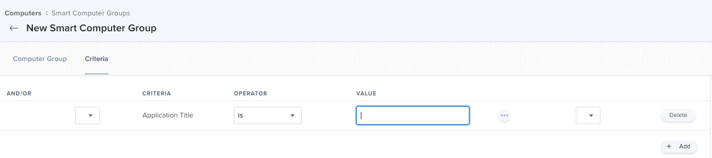

Hi,
We are trying to create a smart group that targets machines that don't have the Falcon Sensor on them.
Weird question. In the criteria for this we want to select an "application title" but are not sure which file that would be. There is no ".app" file for this. Just wondering if anyone has created a smart group with this criteria and knows what to target.
Thanks

There is a Crowdstrike EA already available from Jamf that you could use in the Resources>Extention Attributes. It was working as of March of this year when I last needed it.

Yeah, someone else had mentioned the services option (or i think the criteria is "running processes") but said that the service isn't always guaranteed to be running. I have the attribute from CS resources and it's uploaded ("Displays version of CrowdStrike Falcon Sensor if installed") and it appears now as a criteria for the SG just not sure what goes in the value field.
  • June 25, 2020
Run a recon/inventory update on any machine. The script should return a value that you can check in a computer's inventory, then use it as the criteria value for your Smart Group.
