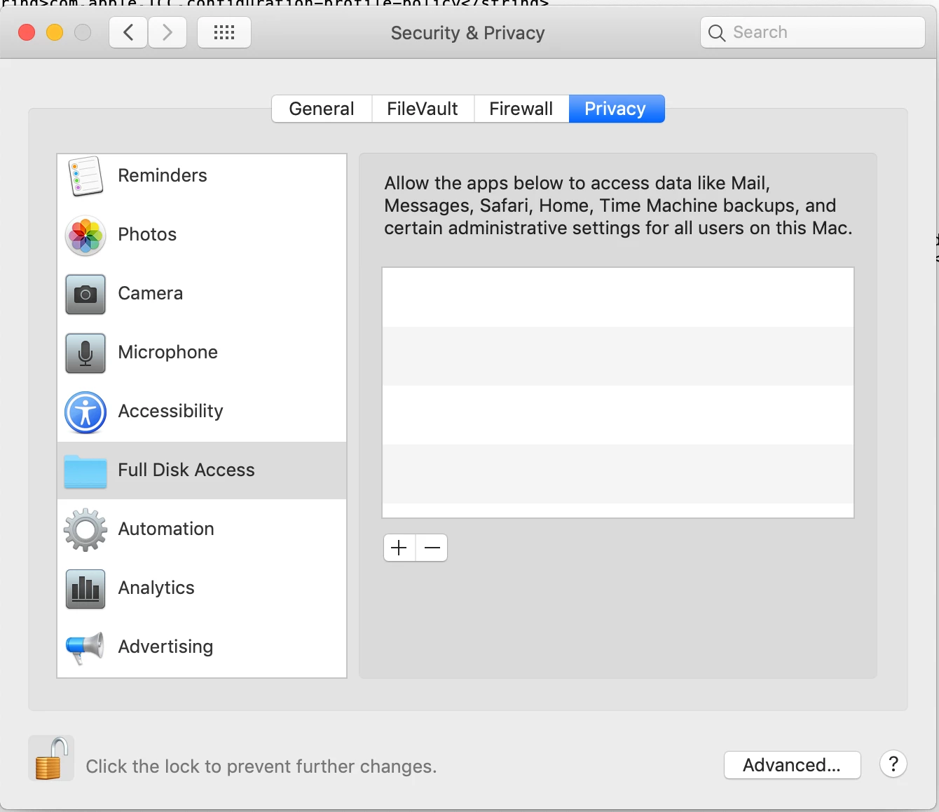

@tlarkin Thanks for sharing the mobileconfig file, mine is almost the same but I noticed that yours says com.company.sensor.payload identifier ID (line13). Mine only has payload identifier ID (see below), Do I need to add it? Also, did you see falcond in Security&Privacy>Privacy>Full Disk Access? I don't see it listed on mine.

You cannot trust the GUI, you need to search for an MDM Override file in /Library/Application Support/com.apple.TCC

@robert.guzman This is a common confusion point. Your only methods to verify whats installed/controlled via mdm deployed configuration profiles is to look at the Profiles pane in System Preferences for the payloads pushed down or look at the MDMOverrides.plist with the following command:
/usr/libexec/PlistBuddy -c "print" /Library/Application Support/com.apple.TCC/MDMOverrides.plist
FYI, Terminal needs Full Disk Access/SystemPolicyAllFiles to read that file otherwise you get the message Error Reading File: /Library/Application Support/com.apple.TCC/MDMOverrides.plist. So basically it's a chicken or the egg scenario, you need TCC access granted to read MDM TCC applied settings. Fun times.
Whats displayed in System Preferences > Security & Privacy > Privacy are only the decisions end users made with prompts presented to them and not settings pushed via Profiles. Its essentially displaying the values that are stored in the TCC databases that can be found at /Library/Application Support/com.apple.TCC/TCC.db or ~/Library/Application Support/com.apple.TCC/TCC.db

So, this is 100% confusing and I had to confirm some of this stuff with an actual Crowdstrike employee on Slack. The actual TCC.db is for Apple Internal use only, and you are not guaranteed anything from it at all. I have two systems right now where one displays the TCC settings for falcond in the TCC.db properly, and the other system it doesn't show up at all.
If you properly deploy the profile you will see the setting in the MDMOverrides.plist file mentioned above. You then should also see very few deny messages in Console.app. Just open up Console.app and search for falcond deny and you will still see some denies, probably around the /prviate/var/folders, and this is expected. Apple does not actually grant full disk access when you enable full disk access, certain parts are still fully denied on disk. Your deny messages should go way down if properly enabled.

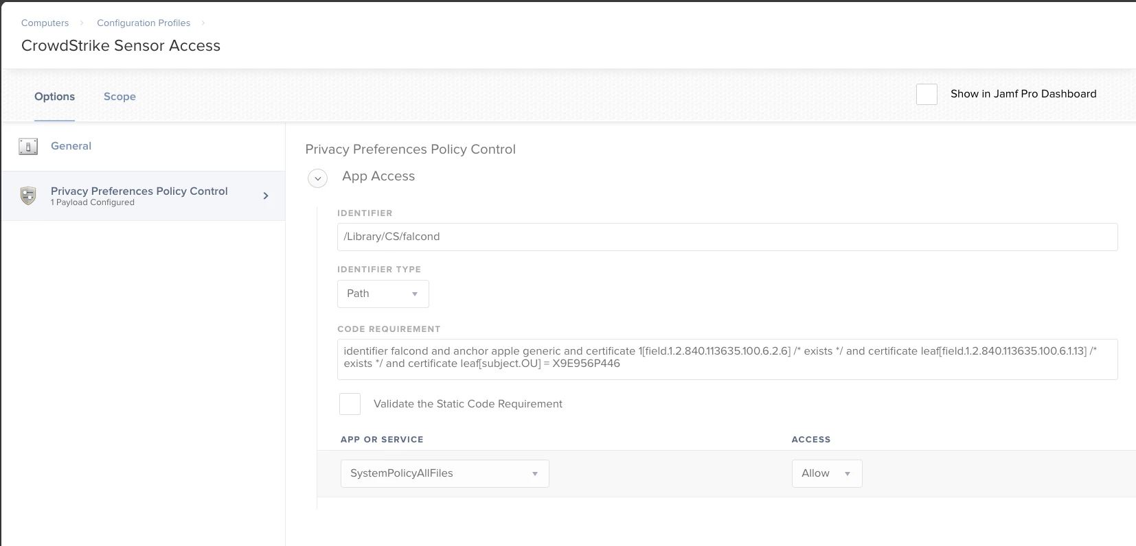

  • November 19, 2019
Sorry for the late responses guys, but I was able to utilize the PPPC utility successfully. It was pretty simple too, "Full Disk access" just equals "All files" in the utility. I just pointed it to falcond, allowed all files access and created the xml. Thanks for eveyones responses on this.

@tyra.robertson @danielgrm I figured out how to get the falcond to be recognized in PPPC Utility. The default permissions on the falcond file is -rwx------ I had to change it to -rwx---r-- and then PPPC Utility would allow me to add it and create a profile with All Files > Allow set

  • December 20, 2019
See attached screen shot to do it via MDM payload

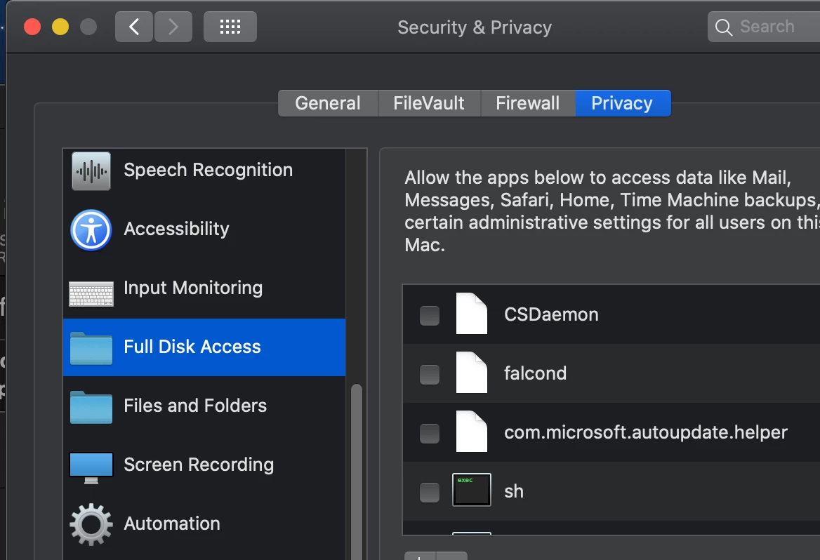

AVmcclint This was what I was trying to accomplish. It adds the app when going to look at system preferences, however, it isn't checked.
beeboo
  • January 23, 2020
i get the same issue, albeit i allowed another option or two just to be extra safe.
Thats what i get, but SSHD is auto checked for me, so im not sure why that is vs the rest of my PPPC.
and to be frank, ONLY SSHD is auto checked, the rest are just entries there with no check mark.
