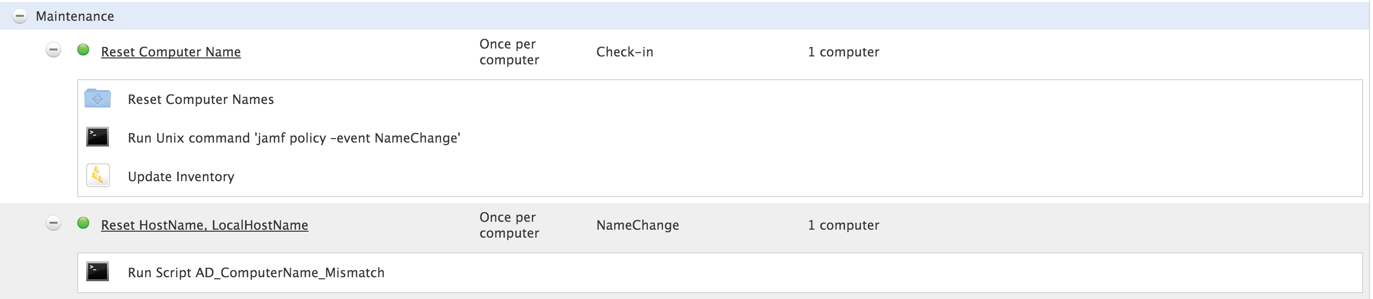

My JSS is running 9.81 and I have been reading a lot about custom triggers and how useful they can be. I am in the process of a few tasks that would very much benefit from this use. However despite my efforts to simplify the workflow as much as possible, I am still receiving the same generic error.

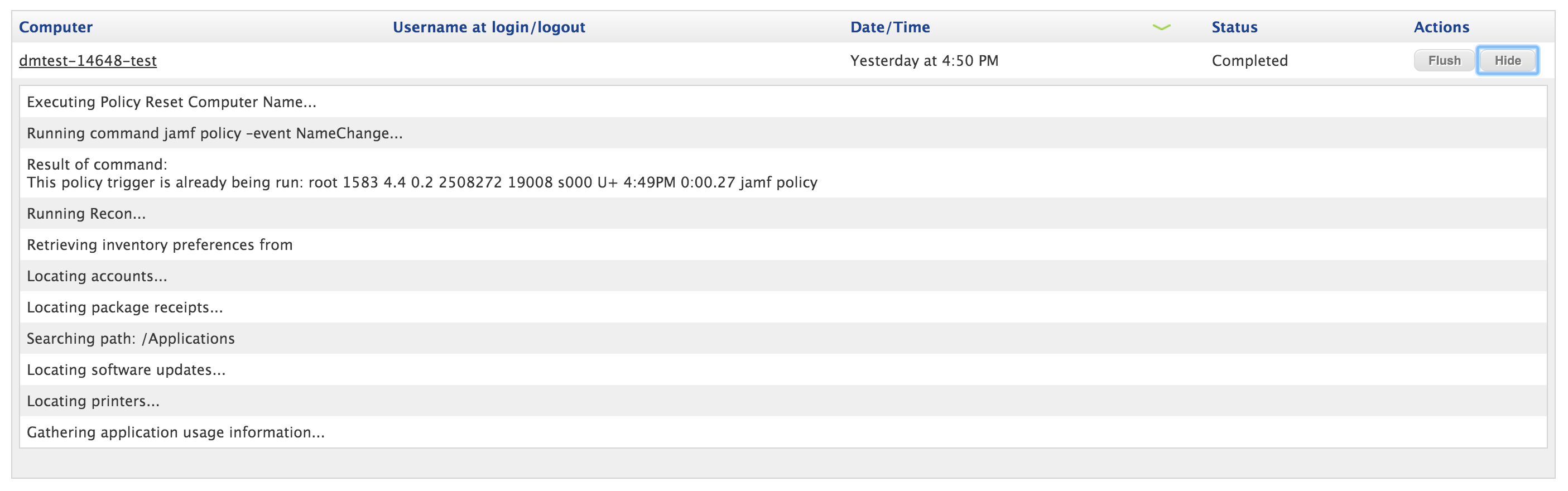

Result of command: This policy trigger is already being run: root 1583 4.4 0.2 2508272 19008 s000 U+ 4:49PM 0:00.27 jamf policy
For some context on the two specific policies, please see below.
I am happy to provide the script provided in the second policy but at this point, I do not think there is much benefit as that portion of the workflow does not even run. The "Reset Computer Name" policy which does successfully complete it's primary task to change the computer name to what is listed in the JSS performs correctly but again as mentioned above, fails to kickstart the custom trigger "NameChange." @ericbenfer and I were working on this together and despite our efforts, kept receiving the same error message provided above Any help would be greatly appreciated!

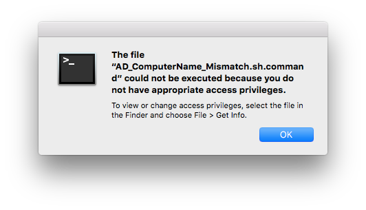

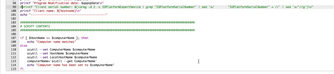

I ran the script, both locally and from Casper Remote, and couldn't get it to fail. To run locally I created a text file named "test.sh", pasted your script in, then ran:
sudo chmod 755 ./test.sh
sudo ./test.sh

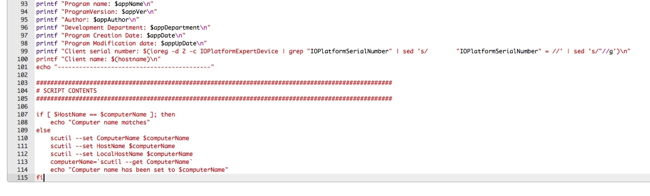

I do see an issue in the JSS Script Editor, it doesn't like something with the quoting in line 99. Atom and TextWrangler don't see a syntax issue, so I don't know what is throwing the JSS for a loop.
Note the syntax color:
And now when I comment out line 99:

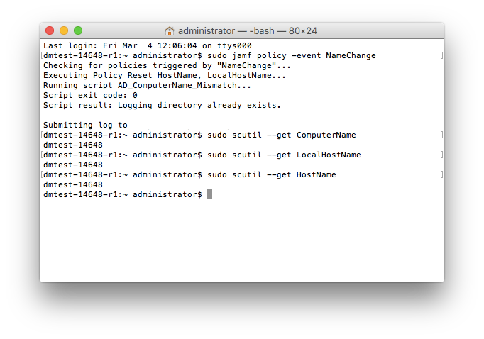

@thoule Here's what I get when running the policy from the machine. I simply open Terminal and enter "sudo jamf policy" to kick-off the check-in.
Fri Mar 04 11:36:23 dmtest-14648-r1 jamf[7055]: Checking for policies triggered by "recurring check-in"... Fri Mar 04 11:36:26 dmtest-14648-r1 jamf[7055]: Executing Policy Reset Computer Name... Fri Mar 04 11:36:26 dmtest-14648-r1 jamf[46]: Network state changed, checking for policies... Fri Mar 04 11:36:26 dmtest-14648-r1 jamf[7055]: Set Computer Name to dmtest-14648 Fri Mar 04 11:36:27 dmtest-14648 jamf[7144]: Checking for policies triggered by "networkStateChange"...
So to me, it doesn't appear that it's running the second policy at all. It's worth noting that the second policy also still shows as "pending" when looking in the logs. Pardon for being naive but what do you specifically mean when you say to "add some log output in the beginning of [the] script?" Still relatively new to scripting so appreciate a little more :)

@Josh.Smith @thoule I neglected to mention that in my testing, this very thing worked. As for this specific, most recent case, it also worked as well. Please find the screen capture below (please ignore the blank field next to "submitting log to..." as I manually removed our JSS link)!

@sepiemoini In your second screenshot the manual trigger call returns an error "This policy trigger is already being run...".
If you you do the following, do you still get the same error in the log or is it different?
1. Flush the policy logs for both policies
2. Reboot the test Mac
3. Rerun the policy

The problem in line 99 is likely in the sed command. Its doing sed 's/"//g' but the double quote within the sed command is probably being seen as a literal open quote and there's no closing one at the end of the line.
You can escape it with a backslash, but here's a better way of grabbing the serial number from ioreg. I use this code all the time in my scripts.
ioreg -rd1 -c IOPlatformExpertDevice | awk -F'"' '/IOPlatformSerialNumber/{print $4}'
The eliminates 2 pipes for grep and one sed command with a single awk to get the same info.
You might still need to escape that double quote within the awk field separator section with a backslash to prevent it from being seen as a literal open double quote. I haven't tested that so I don't know.
Edit: Also, adName can be shortened to:
adName=$(dsconfigad -show | awk '/Computer Account/{print $NF}')

I think I see it now....the error says "jamf policy" is already being run.
    Running command jamf policy –event NameChange...
    Result of command:
This policy trigger is already being run: root             1092   2.5  0.2  2508352  19152 s000  U+    1:24PM   0:00.29 jamf policy
See below. The commands look identical, but they are calling different triggers. The first one was copied and pasted from MS Word, the second was typed in. There is a difference in the "-" character, and since the Word version of "-" isn't recognized, the first one is running "jamf policy" and ignoring the rest of the command.
$ sudo jamf policy –event test2
Checking for policies triggered by "recurring check-in" for user "username"...
No policies were found for the "recurring check-in" trigger.
$ sudo jamf policy -event test2
Checking for policies triggered by "test2" for user "username"...
No policies were found for the "test2" trigger.
Manually delete the "-" in the policy and type a new one...if I'm right then it should work.
sepiemoini
Forum|alt.badge.img+21
  • Employee
  • March 4, 2016
@Josh.Smith I owe you a lot of beer. Many thanks! I can't believe it was THAT easy.

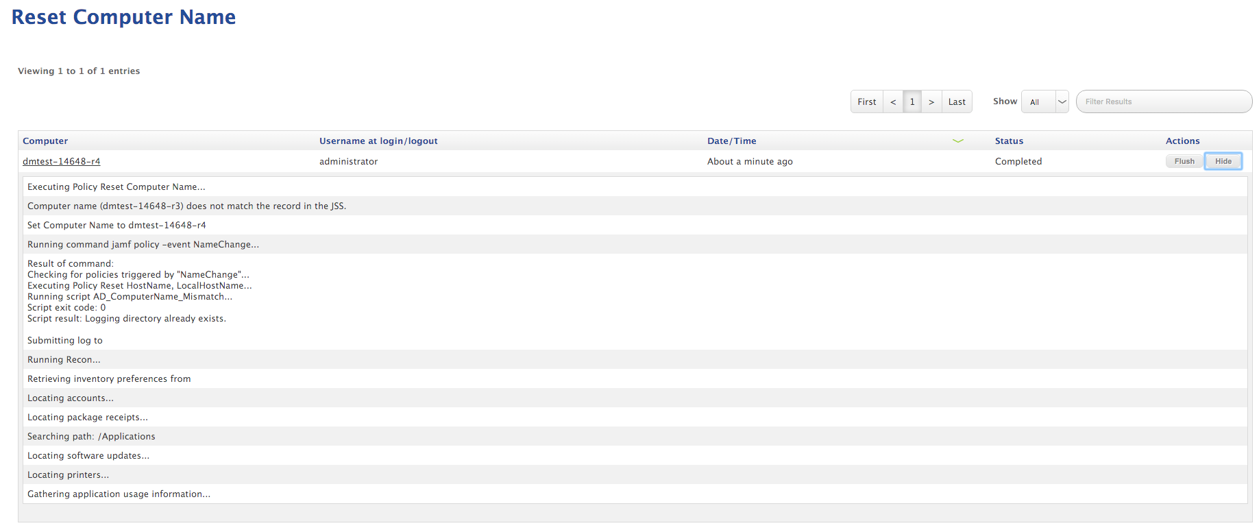

@Josh.Smith @mm2270 I am, however, getting this on the first four clients.
Executing Policy Reset Computer Name (Part 1)... Running command jamf policy -event NameChange... Result of command: sh: jamf: command not found Running Recon...
Any thoughts? The second policy never kicks off :(
UPDATE: added "sudo" to the command but still return the same error.
Executing Policy Reset Computer Name (Part 1)... Running command sudo jamf policy -event NameChange... Result of command: sudo: jamf: command not found Running Recon...

@mm2270 I just checked and a user who received the same "sudo: jamf: command not found" error has the most up to date jamf 9.81binary--the same as our production JSS.
I am not sure how to incorporate the below code since the "sudo jamf policy -event NameChange" is being reference as an execute command in the Files and Processes payload. Where would you recommend updating the below code?
JAMF_BINARY=$(which jamf)
$JAMF_BINARY policy -trigger NameChange

@stevewood @mm2270 @Josh.Smith Thanks for the great feedback! I edited the Execute Command (Files and Processes payload) in the first policy tried the following:
JAMF_BINARY=$(which jamf) && $JAMF_BINARY policy -event NameChange
And got the following for all 4-5 clients that ran the policy already:
Running command JAMF_BINARY=$(which jamf) && $JAMF_BINARY policy -event NameChange...
Result of command:
Running Recon...
Note that the second policy, as stated above, never runs.
UPDATE: trying sudo /usr/local/bin/jamf policy -event NameChange instead of the above since this worked locally when I established an SSH connection to one of the scoped machines. IT WORKKKKKS!!!

Another point I would make, is that your script starts with:
!/bin/sh
!/bin/bash
It shouldn't ! - it should be just:
!/bin/bash
(or just #!/bin/sh) but not both…
However seems to work anyway - even though having both is technically incorrect.
