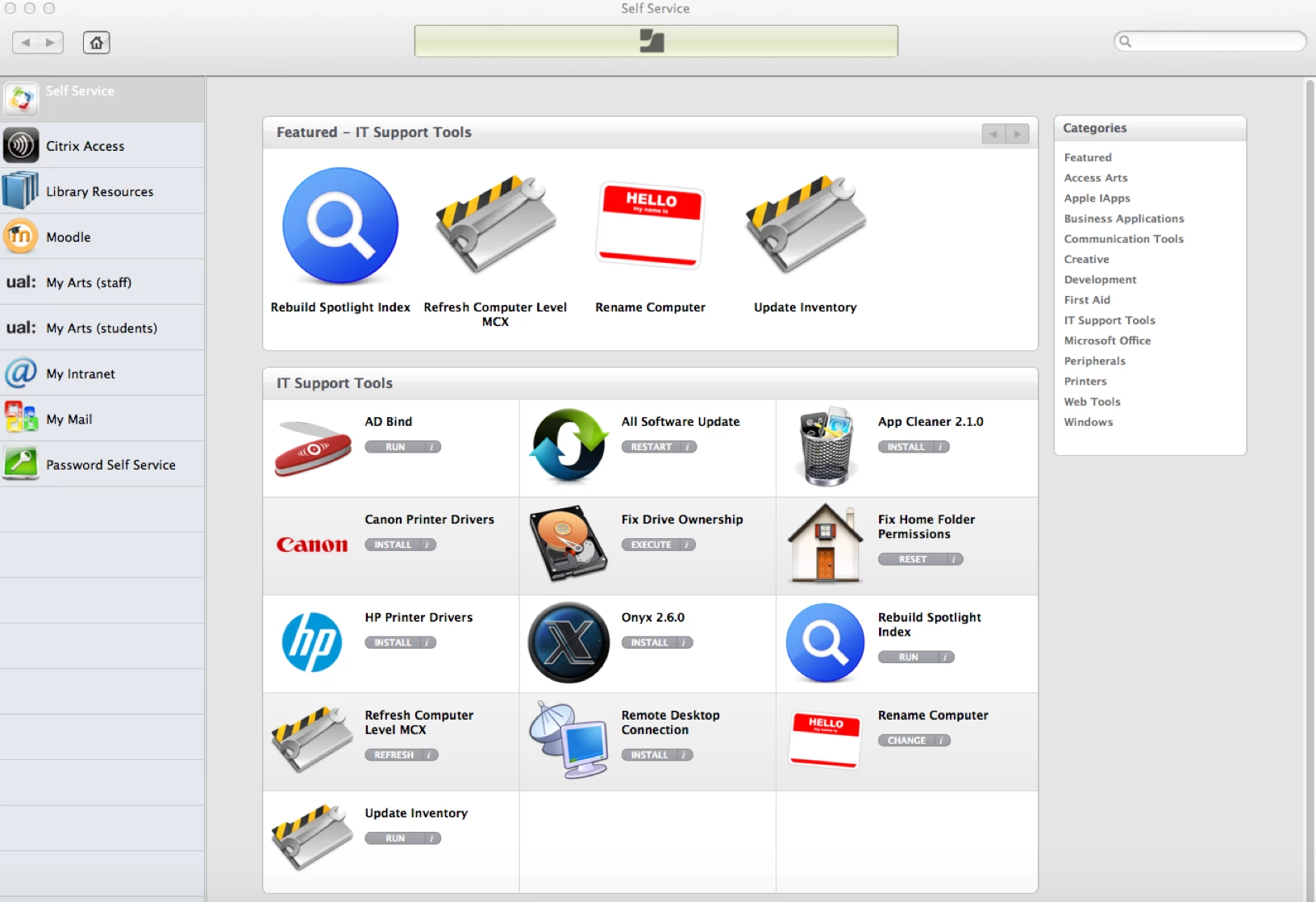

Hi All
Can any tell me how you can customize the view or look of the "self service" window. Like the screenshot for example with a left hand pane and multiple boxes in the middle

The left hand panel is Self Service Plugins, Most people just use URLs with your own icon. (Located in Computer Management-> Self Service Plugins
The Middle, its created by hitting the check box Featured in <Category>
Categories, you can create through Casper Amin

No, its not. Basically, when you select a category from the text list on the right, it will only show that category. If any items within the Category are designated as "featured" for that category, then it appears larger in the box on top. All category items, featured or not, show up in the box underneath, but that's it. You can't have additional categories or category policies showing up under all those.
You can have a main "Featured" category as the landing page when Self Service opens up that will show any items you want from as many different categories as you want, all show up together, but they are not split up by their respective categories. "Featured" is basically a category by itself, so they all show up in one frame.

Looks like some custom CSS in this picture to me... @emilykausalik Do you know who made this one?

Looks like an old version of Self Service… UAL so maybe a university of some sort? That Featured area would be more than just custom CSS; that'd be a whole other HTML element built into the main landing page of the JSS. Maybe SS looked like this in the past? Or maybe a mock-up? Or someone spent a lot of time building out custom HTML only to have to rebuild it every time they updated their JSS…
(University of the Arts London, if my Google-fu did me any justice. )

Actually, I'm almost certain that this is just how Self Service looked back in the version 8.x days folks. Not sure that there was anything special from a CSS/server standpoint going on here.
Before JAMF added the "Featured" banner functionality to Self Service, I believe when you checked the box to have a policy 'featured' within its own category, and you selected that category from the sidebar, that it appeared in a top box as shown above. All Self Service items within the category (featured or not) would appear in the larger box below that, just as you see in the screenshot.
Also, as you can see in the screenshot, the Self Service icon is old, there is no JSS URL below the Self Service icon, which has been around now for a while, and there is no "user" logged in section above Categories. In short, I think this is simply a pre version 9, or perhaps very early version 9 view of Self Service and nothing more. I may be wrong, but I seem to recall Self Service working the way as its shown above. We were kind of late converts to version 9.x, so the old way the JSS and Self Service appeared haven't faded from my mind just yet. :)
