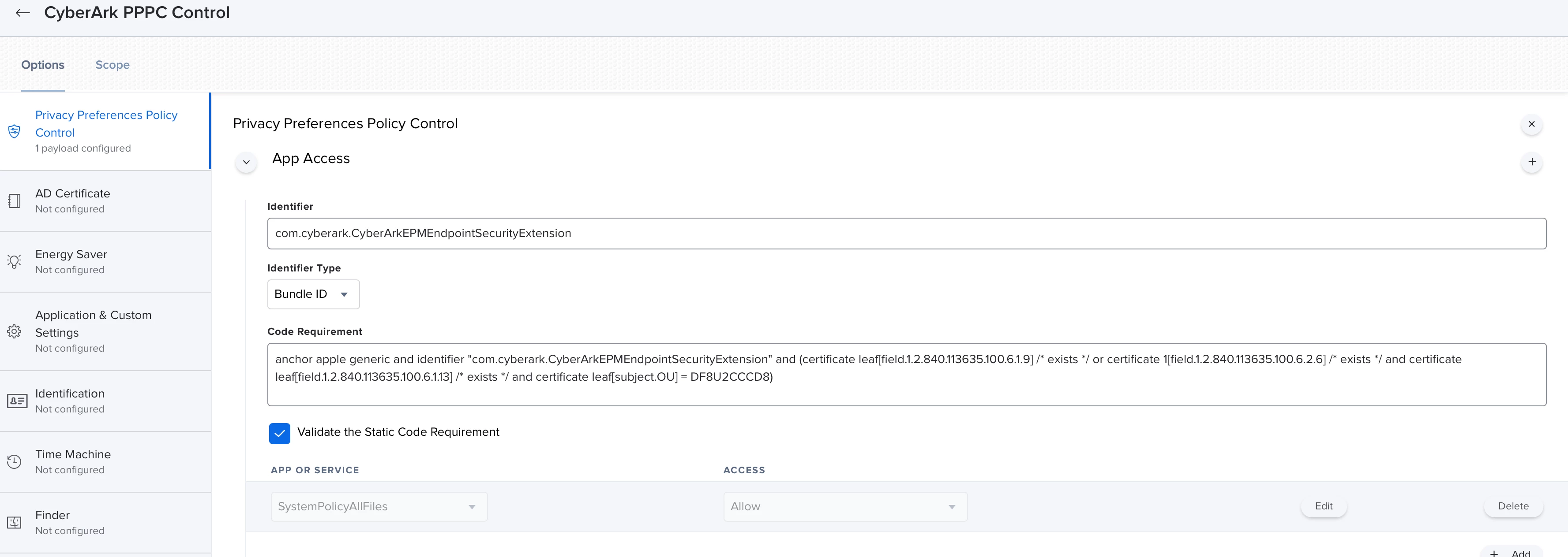

@KCouture - this is essentially how I was able to get this to function in our environment as well, with one exception, we also added the PPPC settings that @spraguga provided above, I believe this will solve your app downloaded from the internet prompt(though don't quote me on that as I've only tested on 10.14 and 10.15 machines.

I do have a PPPC made up for it, but mine looks different than yours. I did make mine with the old version of Cyberark installed so I'll give that a go
  • Dec 7, 2020 4:01 PM UTC
Sadly no change when I change my PPPC full disk. Maybe it needs to be compatible with Big Sur? My version of PPPC has a button for that
  • Dec 8, 2020 7:11 PM UTC
Have you tried checking the "Validate the Static Code Requirement" checkbox? That's the only difference I see between yours and ours.

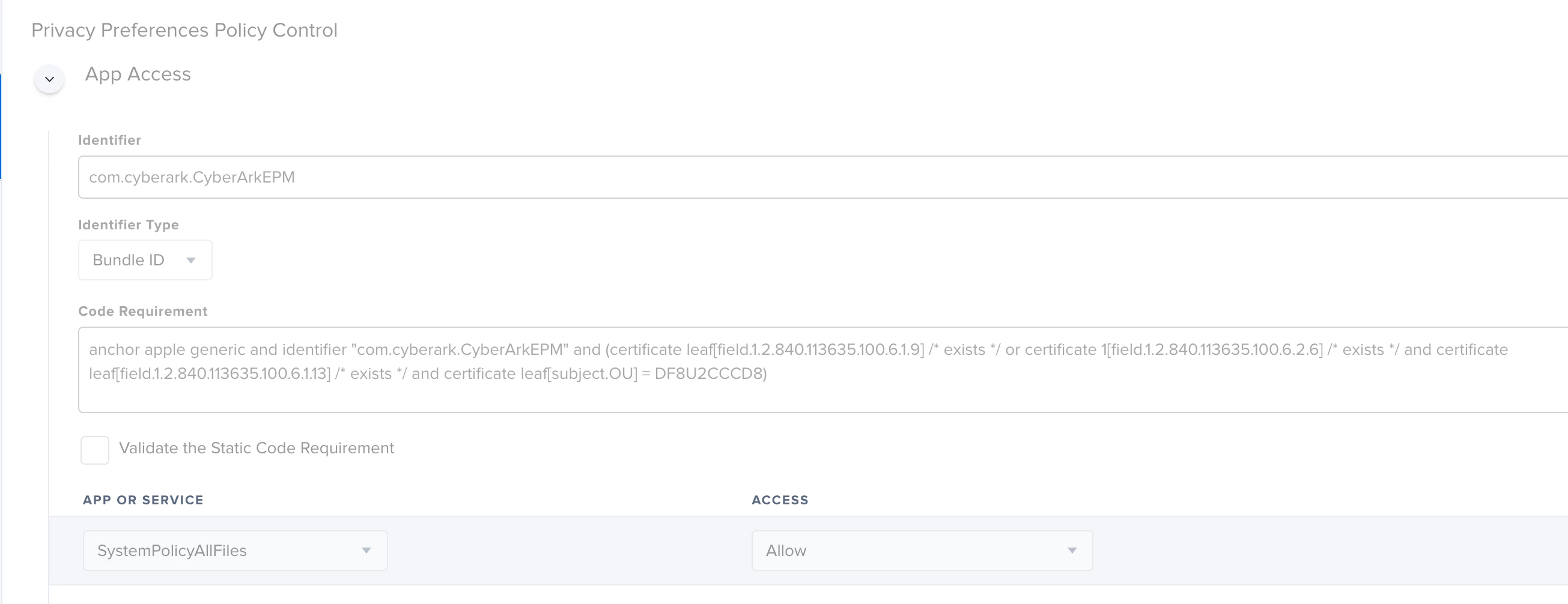

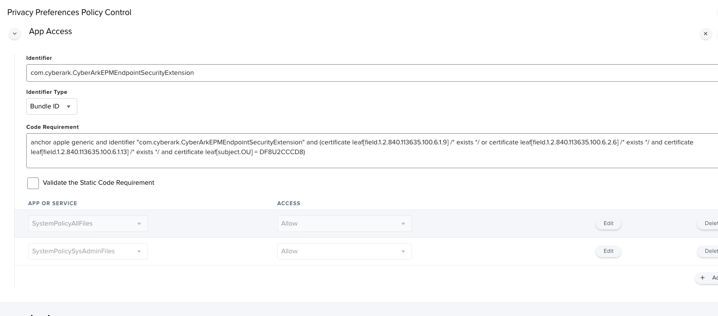

  • May 4, 2021 4:11 PM UTC
@brianmcbride99 Any Update on how to have the PPPC Config not fail after scoping?
  • May 4, 2021 4:26 PM UTC
@tvargas - yes - apologies i meant to update this thread and forgot....there was actually a formatting issue in the PDF published by cyberark, it took a support call and digging into it to find out...an extra whitespace if i remember correctly. I was copying/pasting the PPPC code. i would have expected them to update their PDF by now, but if not here is the PPPC section of the config profile we are using:
The code requirement for this identifier 'com.cyberark.CyberArkEPMEndpointSecurityExtension' is:
anchor apple generic and identifier "com.cyberark.CyberArkEPMEndpointSecurityExtension" and (certificate leaf[field.1.2.840.113635.100.6.1.9] /* exists */ or certificate leaf[field.1.2.840.113635.100.6.2.6] /* exists */ and certificate leaf[field.1.2.840.113635.100.6.1.13] /* exists */ and certificate leaf[subject.OU] = DF8U2CCCD8)
The code requirement for this identifier 'com.cyberark.CyberArkEPM' is:
anchor apple generic and identifier "com.cyberark.CyberArkEPM" and (certificate leaf[field.1.2.840.113635.100.6.1.9] /* exists */ or certificate 1[field.1.2.840.113635.100.6.2.6] /* exists */ and certificate leaf[field.1.2.840.113635.100.6.1.13] /* exists */ and certificate leaf[subject.OU] = DF8U2CCCD8)
EDIT: The screenshots are reversed from the order i uploaded them, sorry about that, but you should get the gist.
please note the instruction guide you to validate it's a one line config as PDF adds CR in the middle...
  1. Code Requirement (Verify the below is ONE line!): anchor apple generic and identifier "com.cyberark.CyberArkEPM" and (certificate leaf[field.1.2.840.113635.100.6.1.9] /* exists */ or certificate 1[field.1.2.840.113635.100.6.2.6] /* exists */ and certificate leaf[field.1.2.840.113635.100.6.1.13] /* exists */ and certificate leaf[subject.OU] = DF8U2CCCD8)
