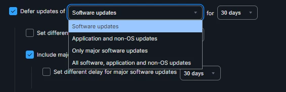

I'm using a .mobileconfig configuration profile through iMazing to postpone the installation for 90 days.
https://github.com/chrisbasse/Ignore-Tahoe-for-90-days.mobileconfig
Regards

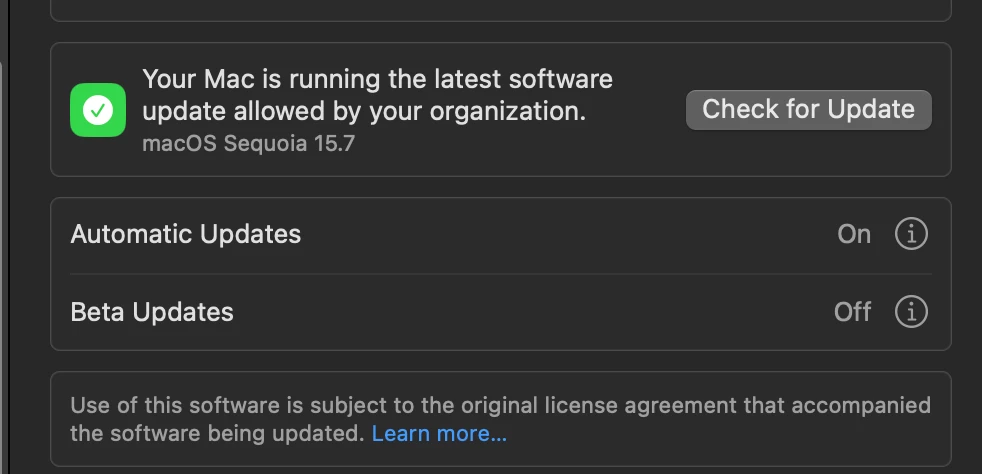

Thanks mvu
Yes I double check any possible double configuration but no.
I found why, upload the script via uplodaing a .mobileconfig file as explain by cricri_mac.
The best way is to createa configuration profiles, and Applications$custom settings, Upload,
and
Preference Domain  : type :   com.apple.applicationaccess
and paste you .xml code Option A or B, and save and apply to your scope
I put the B xml script
Update in general propoe only now MasOS Sequoia 15.5
I have not the same screen as you “Your Mac……. by your organisation” but it work fine now
Merci!
Rectification, asap you did all possible allowed updates (MacOS and Safari) I got the same message you…
