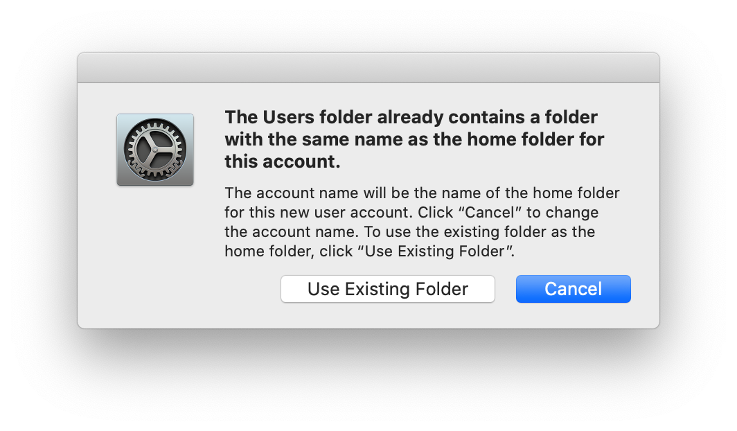

Forum|alt.badge.img+15
  • November 13, 2019
I made a minor correction to my steps (the DMG contains the contents of the user folder, not the user folder,) but the method I described definitely still works even on Catalina. And, it means no root user, no Terminal commands, etc. because System Preferences does all the work for you. Here is Catalina's popup:
