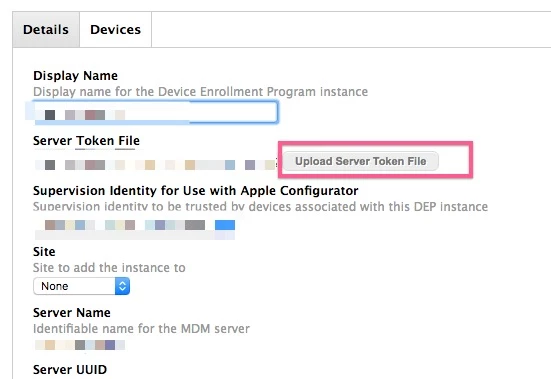

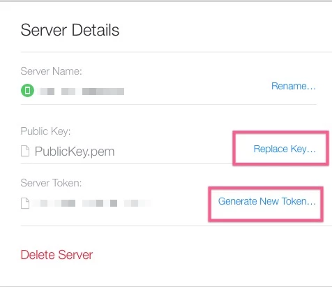

@maristchris My assumption is that you will need to redo your DEP token by downloading a new public key from the JSS DEP section and then in the DEP portal replacing the public key then generating a new token that you would upload into the JSS by editing your current DEP entry and uploading the new token.

Well I think you still will have to. The original public key you used to set up your mdm in the DEP portal with apple had the old URL to look for your Casper server embedded in it. Unless you update I think it's going to be sending clients to your old URL.
