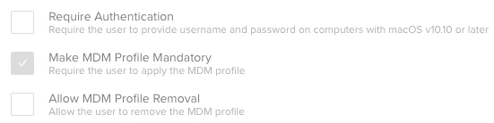

We ran into this same issue. Our setup is exactly the same as yours. Make sure in your PreStage that "Allow MDM Profile Removal" is checked, or else it will never show. We tried absolutely everything, and this was the only thing to finally solve it.
Let me know if it works once you give that a go.
I have the same problem. I changed the PreStage to "Allow MDM Removal" and still no go... MDM Capability, Enrolled via DEP, and User Approved MDM are all "Yes" on the device record but still no MDM Capable User. When attempting "sudo jamf mdm -userLevelMdm" I get this in the terminal output:

I can confirm that the workaround seems to be to change the Prestage enrollment to "Allow MDM Removal", and run "sudo jamf mdm -userLevelMdm" after Prestage enrollment.
This does, however, not help for the computers already enrolled with the previous version of the Prestage enrollment...
@whitebeer You are right, the jamf mdm command removes the Enrolled via DEP flag, as well as User Approved MDM. It is not a good workaround.... I also agree that the Jamf Connect documentation lacks about everything needed to make a good user experience. Take a look at this post, which is the best I have found so far.
