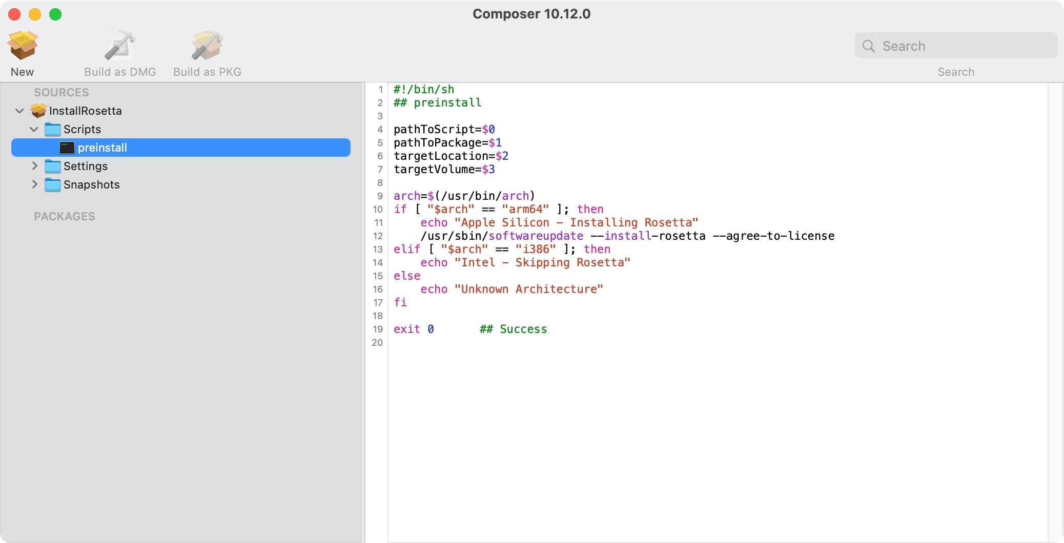

@txhaflaire how would you package the scrip on prestage? So this will ignore intel machines and only install on m1. looks good
!/bin/bash
arch=$(/usr/bin/arch)
if [ "$arch" == "arm64" ]; then echo "Apple Silicon - Installing Rosetta" /usr/sbin/softwareupdate --install-rosetta --agree-to-license
elif [ "$arch" == "i386" ]; then echo "Intel - Skipping Rosetta"
else echo "Unknown Architecture"

@dmiguel Just set it as a postinstall script when creating your package and that simply it is.

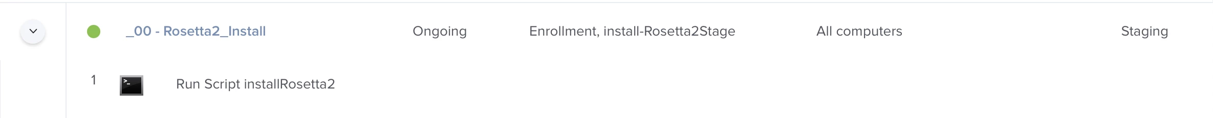

Sure. So here's how I have everything work. 1. Smart Group with the criteria for Architecture Type is arm64
2. You will want to create two scripts. The first is simple script to install Rosetta
3. The second script is to trigger all the remainder policies using sudo jamf policy -event trigger unless you're using DEPNotify.
4. Next I created a policy that only runs with the smart group for M1 processors. The triggers are Enrollment and a Custom Event called install-rosetta (just in case I need to use it manually or via another script).
5. Then I created a second policy to run after Rosetta is installed which fires off the second script that runs the remainder of the policies. That one is only set to run via Custom Event start-enrollmentinstallers.
So far everything is working. I'm testing out DEPNotify which does change how this is done but for now, it's fine.

For prestage enrollments you can create a prestage package which runs a simple script with something like below for instance
Did you actually try this?
I used Composer to create an "empty" package with a preinstall script inside. However when running this on an M1 mac without Rosetta, it says:
To install "package", you need to install Rosetta. Do you want to install it now?
so I'm back to square one.

@michael.madsen I use the following script (credit to rtrouton) in a Policy with the "Enrollment" trigger. This is scoped to all machines as the script has logic to exit if it detects an intel Mac. The policy name begins with < _00 - > forcing it to run 1st in our enrollment process. Seems to work extremely well, but of course more testing is needed. Hope this helps.

Here is what I did...
I created an "empty" package with a preinstall script like this:
I tried running this on an M1 mac where Rosetta was not installed (just run manually from desktop). However, it complained:
However I googled for a while and found that I could expand InstallRosetta.pkg with:
pkgutil --expand "InstallRosetta.pkg" "InstallRosetta"
Then I used BBEdit to edit the file: InstallRosetta/Distribution and added: <options hostArchitectures="arm64,x86_64" />
Then I used command:
pkgutil --flatten "InstallRosetta" "InstallRosetta.pkg"
to put files back to a .pkg again.
Now when I ran the package again on the M1 mac, it didn't complain that Rosetta was missing and when it completed, it had actually installed Rosetta.
So I uploaded this package and added it to our prestage enrollment.
However it still doesn't work :(
I'm not sure why.
