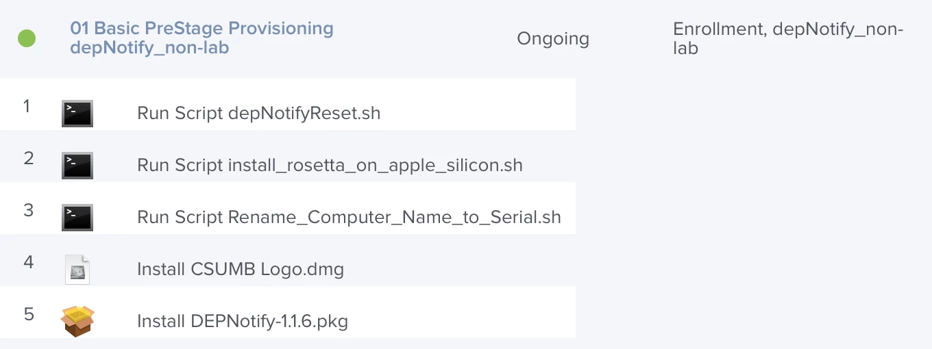

Wow, this is pretty freaking awesome. Thanks, for sharing this. I am going to give this a try. I'm curious how to execute was workflow like this utilizing DEPNotify.  Fascinating!
Use a script to install rosetta, and trigger it 'Before' other tasks in your provisioning policies. For example, this is our depNotify-based policy that's triggered by Enrollment. At the end (cut off from the screenshot) is our customized depNotify-starter script, running 'After' everything else.
  • Aug 18, 2021 1:45 PM UTC
Step 1
In Sum, use the "*". Build your workflows to stagger using triggers.
The M1 Policy is a Run Unix Command '
/usr/sbin/softwareupdate --install-rosetta --agree-to-license'
Your # 1 Policy is
Once per computerEnrollmentAll computers, All users, Kiosk - Zoom Room excludedNone
Run Unix command '/usr/sbin/softwareupdate --install-rosetta --agree-to-license; /usr/local/bin/jamf policy -event baseapps'

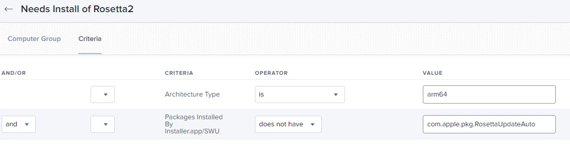

Our approach to installing Rosetta 2 before the applications that need it:
  1. Create a new script in Settings --> Computer Management called "Install Rosetta 2" that runs "/usr/sbin/softwareupdate --install-rosetta --agree-to-license"
  2. Create a smart group called "Needs Install: Rosetta 2". Set criteria to "Architecture Type 'is' arm64" AND "Packages Installed By Installer.app/SWU 'does not have' com.apple.pkg.RosettaUpdateAuto"
  3. Create a policy called "Install Rosetta 2" with the scope target set to the "Needs Install: Rosetta 2" smart group, and have it run the "Install Rosetta 2" script.
That takes care of installing Rosetta 2 on ARM macs. Then for each Intel application X, create a smart group similar to above called "Needs Install: X" that finds computers without the application. Then configure a policy that installs X for members of that smart group, but add the "Needs Install: Rosetta 2" smart group to the exclusions list. That way, Intel and ARM macs share most of the configuration - it's just that ARM macs won't install X until Rosetta 2 has been installed.

Name the policy so that it's alphabetically first. Generally you can add "001" or something similar to the beginning of the policy name. This will have it run before other policies.
howie_isaacks
  • Nov 11, 2021 2:04 PM UTC
I created a policy that runs this script and then I put it into my policy array. It works every time.
#!/bin/sh #Checks if a Mac is Apple Silicon or Intel. Installs Rosetta if the Mac is Apple Silicon. arch=$(/usr/bin/arch) if [ "$arch" == "arm64" ]; then echo "Apple Silicon - Installing Rosetta" /usr/sbin/softwareupdate --install-rosetta --agree-to-license elif [ "$arch" == "i386" ]; then echo "Intel - Skipping Rosetta" else echo "Unknown Architecture" fi
  • Nov 15, 2021 12:56 PM UTC
Thank you that worked.

So, I got this working. What I did was create a Smart Group for M1 machines. Then, then only policy that I had that kicked off as Enrollment complete is one that installs Rosetta. If it's not an M1 then it kicks off the rest of the policies. Once Rosetta is install I have an event trigger that fires off the rest of the policies. So far it's worked. This allows me more flexibility to quickly change around policies.
What settings did you use on your smart group to determine if a system is a M1?
Jason33
  • Feb 5, 2022 2:25 PM UTC
For my Smart Group I used this criteria:
Processor Type like Apple
Architecture Type is arm64

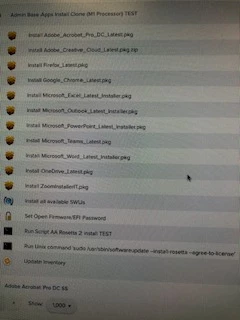

Hi Jeff,
After our devices are enrolled, I manually, (meaning its not part of the enrollment)  run a policy called  "Admin Base Apps Installs" that includes Adobe, Office, Zoom, Teams etc. and finally configures the firmware settings
In that same policy, I want to install Rosetta first, and put it at the top of the list, as install applications fail without Rosetta.
Question. In that same "Base Apps install" policy, will the Files and Process run first?
Or do I create a separate policiy and some how link the two?
fyi I haven't removed the Run script yet shown in the pic so you can disregard it as it fails to run first.
I'm 3 months into the apple world and running into some roadblocks.
Appreciate the help
