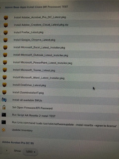

Hi Jeff,
After our devices are enrolled, I manually, (meaning its not part of the enrollment)  run a policy called  "Admin Base Apps Installs" that includes Adobe, Office, Zoom, Teams etc. and finally configures the firmware settings
In that same policy, I want to install Rosetta first, and put it at the top of the list, as install applications fail without Rosetta.
Question. In that same "Base Apps install" policy, will the Files and Process run first?
Or do I create a separate policiy and some how link the two?
fyi I haven't removed the Run script yet shown in the pic so you can disregard it as it fails to run first.
I'm 3 months into the apple world and running into some roadblocks.
Appreciate the help

@JM14_2 Put the commands to install Rosetta if needed into a script, and then have that script as a payload in your policy set to Run Before
