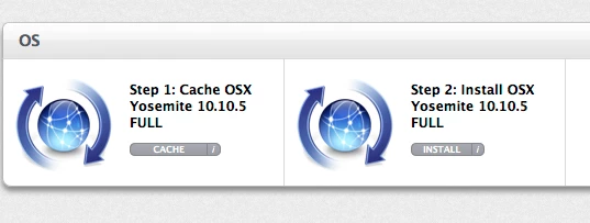

Alright... it took me some time to finally come back around to this but I am deploying the .pkg downloaded from:
https://support.apple.com/kb/dl1832?locale=en_US
to some of my users machines (presently only verified that mid-2012 MBPro's and some pre 2015 iMacs function with this). The .pkg was simply dragged to Casper Admin and distributed via Self-Service policy. No funny configuration. I will finally make it around to testing on some newer retinas and MBAirs.
Just FYI.
