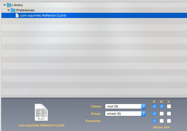

  • April 28, 2015
@mjohnson
Navigate to: /Library/Preferences/
drag the plist into a composer window, package it up with permissions of root:wheel Read Write
Read Read
(mode 644)
Package up (separately from the app, as then you can just build Airparrot 2 as a separate app, instead of licensing it every time)

  • April 28, 2015
@mjohnston Take the plist with the license info from your ~/Library/Preferences folder and put it into /Library/Preferences in Composer.

  • April 28, 2015
@mcooper I did the old switcharoo like you suggested.
Put my known good plist file into the Composer source that points to /Library/Preferences.
Made a pkg from it and pushed it to an unlicensed machine and it's no longer says trial version.
I think we're good!
