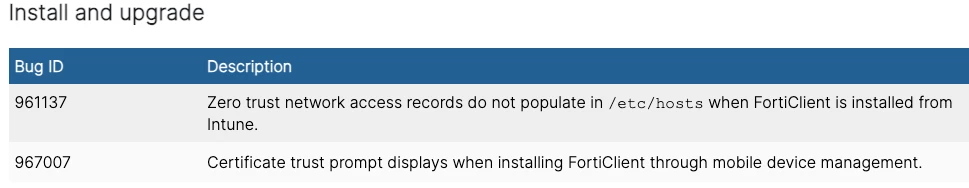

  • Feb 13, 2024 9:53 AM UTC
Regarding the certificate prompt... It looks like the issue is not there anymore with FortiClient 7.0.11. Please, see the documentation:
ref. https://docs.fortinet.com/document/forticlient/7.0.11/macos-release-notes/510031/resolved-issues
We did some testing since Friday and the issue didn't occur indeed so seems to be fixed.
