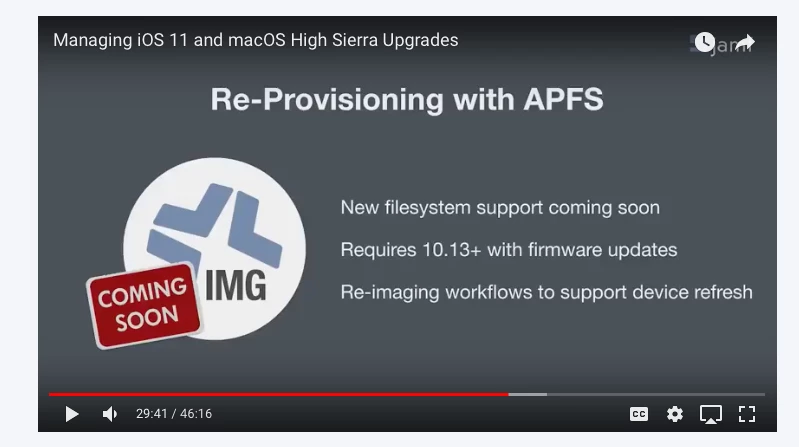

dstranathan
Forum|alt.badge.img+20
  • Feb 5, 2018 1:48 PM UTC
@allanp81 Can you elaborate on this process please? I dont see specific firmware updates on my SUS. Im curious about the details on your process.
  • Feb 6, 2018 1:23 AM UTC
@chrisdaggett You cant just restore a HFS+ version of 10.13 on a mac that has never run high sierra before. There is more to the firmware than just the boot loader for APFS. Once you have upgrade to high sierra there is no longer an issue in imaging directly to 10.13 and that is why my script will detect what the currently installed OS is and deploy a 10.13 image if the current OS is already 10.13, otherwise it will deploy 10.12.6.
Directly from the from the apple support article:
https://support.apple.com/en-us/HT208020
Monolithic system imaging can only be used to re-install macOS, not to upgrade to a new macOS version. If you try to use a monolithic system image, required firmware updates will be missing from the installation. This causes the Mac to operate in an unsupported and unstable state. You can use system images to re-install the existing operating system on a Mac.
dstranathan
  • Feb 6, 2018 5:19 PM UTC
Jamf: When is "soon"?
